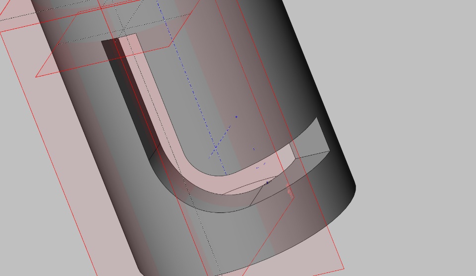

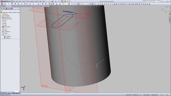

I am trying to make, for lack of the termonoligy, a spring loaded, push pin that drops 1/2" and twists 90deg then spring up into a pocket locking the pin.
I have tryed using 3D sketch but I have to fudge the numbers even to get it close and even then it ;eaves the cut surfaces incomplete. I hav also tried
usin the wrap tool but it leaves the path tappered.

You should use a solid swept cut for this.

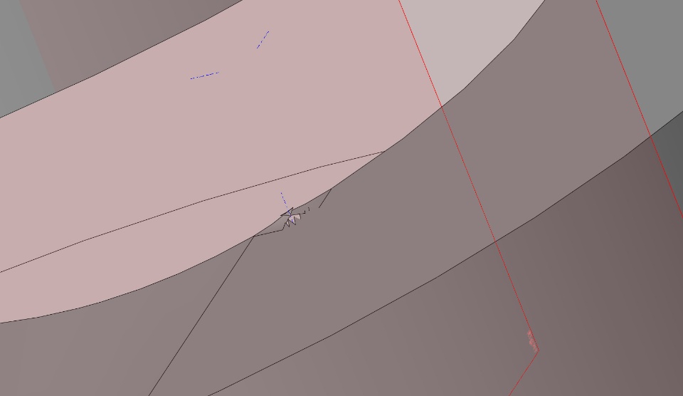

First, sorry about my spelling, lol. I think I tried that. See attatchment, and it leave the surfaces jagged.

Is this what you were trying to do? I did an extruded cut from the top plane following the path of the swept cut you were trying to do. It appears like everything is normal but I am not sure if this is your intent or not. I know it is not a twisting cut but I believe this will get you the result your looking for.
