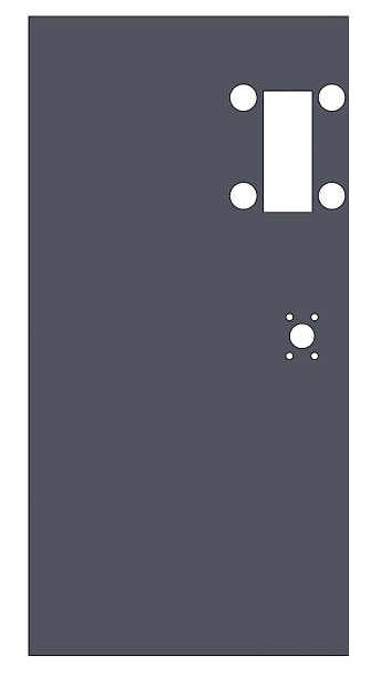

Hi,
I am planning to make a macro to dimension multiple different files that has cutouts with more than one shapes. I just want it to dimension the midpoint of the feature to the edges. The attached picture is an example. imagine a door knob with screw holes. I jsut want to dimension where the middle of the knob will be at from the edges, not the screw holes etc. How can i do that with macros? I am new to it so can you please give me example macros and help files. Thanks.

yup i tried. but since the location of the cutouts varies part by part... its hard. I have over 300 different parts that are similar but the location of the cutouts varies. the cutout is a library feature,

I assume you're talking about adding these dimensions in a drawing. But I can't tell whether you're importing existing dimensions or adding a custom smart dimension. If the former then I think Deepak's method would work. If the latter then this would be a serious undertaking, probably not one that is worth trying to program yourself if you're new to API.
