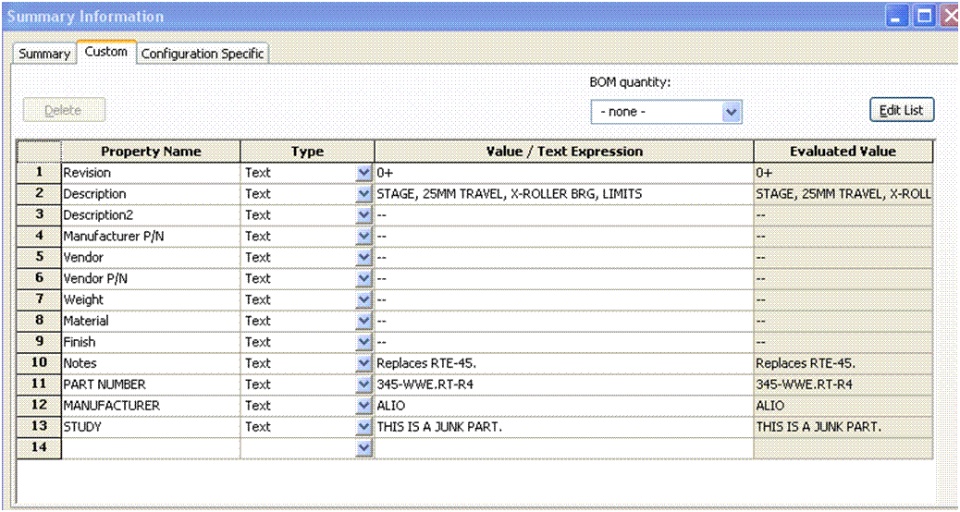

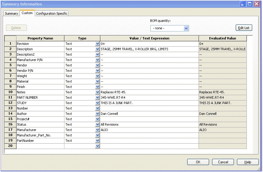

I created a new part template that has 12 Property Name fields.  When I check the part into PDM and then check it back out, 6 additional fields have been added to the Property Name fields: Author, Number, Project#, Status, Manufacturer_Part_No. and PartNumber.  I thought that the list of available properties was controlled by the properties.txt file so I found the file (it was not where the File Locations indicated it would be) and modified it.  Now when I select Edit List inside Summary Information, I do only see the properties in the properties.txt file, but what is adding the other 6 fields and how do I edit this?  I now have Part Number, PartNumber and Number.
The image on the left is just prior to check-in to PDM.  The image on the right is after I checked it out from PDM.  There are now 19 Property Name fields.

Author, Number, Project, and Status are PDM fields.  They get added to all files on check in.  So do Revision and Description, but you already had those.   Author, Project, Revision and Status will get their values FORCED in by the PDM software, overwriting any changes to those.
Check your vaultadmin program, properties tab for the Manufacturer_Part_No. and PartNumber mapping.  If you rename them to your existing "Manufacturer P/N" and "Part Number" the mis-named ones wont get added either.
This has nothing to do with the properties.txt file, that just controls what people see in the pull-down menu.
