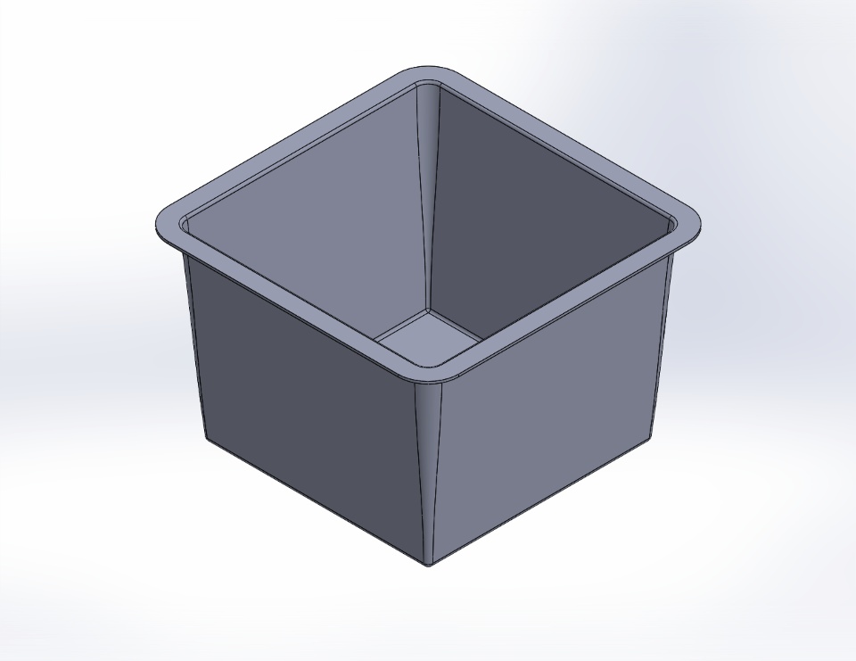

I want to be able to show this part in flatten view in drawing, how should I go about doing it?

Hello,
That looks like a stamping.
If you want to replicate it in SW sheet metal, it will be a welded assembly.
The sides you can make from a lofted bend with a vertical weld seam placed at your choosing.
The bottom can be made from one piece (attached) but it may be better to model up a flat piece with radius corners and weld all around.
The top ring will also be a flat piece with a weld all around.
Cut the bottom flat from the inner waste of the top ring to increase yield.
