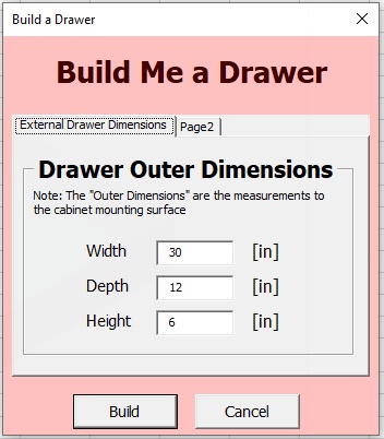

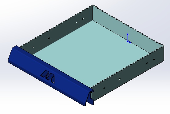

I have a multi body sheet metal part [Drawer] that is equation driven and GUI controlled.
The GUI allows users to enter in any Length, Width and Height and it updates the Global Variables and all the dimensions in the part change.

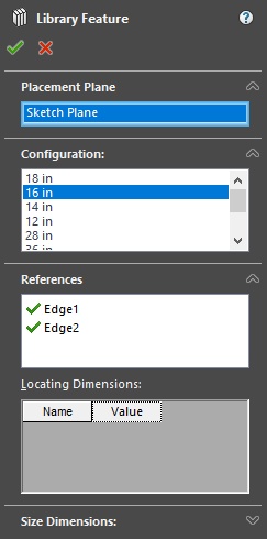

The problem I am having is that depending on the drawer depth, different slides will be used. The bolt pattern for the slides are all saved as different configurations within a library feature.
I have looked high and low for a way to change the library configuration through VBA.

I am able to 'Read' the Library Feature through:
Dim LibraryFeatureData As LibraryFeatureData
Set LibraryFeatureData = Feature.GetDefinition
ConfigurationName = LibraryFeatureData.ConfigurationName
How do I write to this value????
(Note the library feature is already inserted into the model, I want to switch between configurations only of the library feature, I don't want to change the part configuration)
