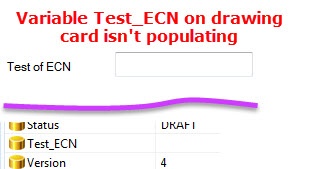

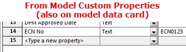

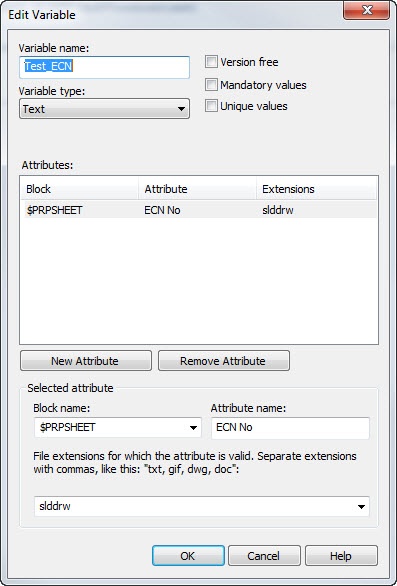

I am trying to setup our system so that the drawing data cards will auto populate based on data from the models. This seemed straight forward from other posts that I have seen, but it isn't working for some reason. The first screen shot is of the variable "Test_ECN" which is intended to populate with the variable "ECN No" that is contained in the model. The 2nd screen shot shows that the model indeed has the custom property ECN No filled out. The 3rd screen shot shows that the drawing isn't updating. I'm hoping someone with a trained eye can quickly see where I've gone wrong.

Bryan,
Okay, your attribute block name should be CustomProperties. Missed that last time, sorry about that.

Then how does it know to get that information from the model instead of the drawing? Where would the $PRPSHEET go?

This is how I have it set up, notice the second block with the other extensions.

It is funny you say this because I came across specific instructions in the EPDM Help. It instructs me to do exactly as you have done, but it still isn't working for me. May I ask what version of EPDM you are using? I'm using EPDM 14.1 (B616). I'm going to continue trying to trouble shoot using the setup you suggest.

It appears to be working. Your setup is correct and I think Rob D was also correct in that I needed to make a new part with my new rules in place. Thank you for your help.

I was just going through all of my variables....  Everything I have populating from the part --> drawing has the $PRPSHEET and CustomPoperty set up as it is in the pic.

We do all of our data input through the data cards. I have not seen an instance where a value I typed in was over written. I have noticed that the drawing value does not update until the drawing is saved. I'm guessing over time this will become a slight annoyance. But the Pro's outweigh the Con's in our case.
