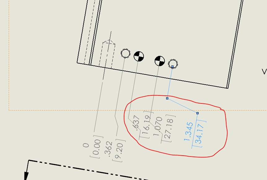

I frequently run into this problem when I add ordinate dimensions to auxiliary views.  I add ordinate dimensions, but unless I stretch them way out, they start flipping back on themselves.  See the circled dimensions in the attached screen shot.  There must be a setting which prevents this, or an override.  I'm currently running 2014, but I've run into this problem on every version I've used in the last seven years.

I'd be willing to bet this only happens with Ordinate Dimensions that aren't horizontal or vertical?  I use them all the time and don't remember having that problem, but mine are rarely (if ever) at an angle.  I'd be surprised if it's a setting.  I hope someone else can help, but if not I'd suggest you report it to your VAR as a possible bug.

You're correct.  It only happens with angled ordinate dimensions, such as the ones shown in my example.
