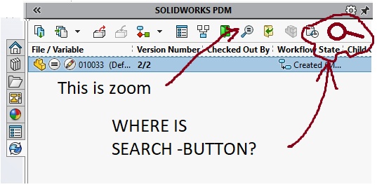

I have weired problem. I have Solidworks PDM in use and should find a document. I know it is there, I know it's name, but how can I find it? Where is the search -button in PDM-window?
If I navigate to PDM by windows explorer, there is a search, but only for Engineering Search and that doesn't include search by name. Am I missing something? How do I search by name?

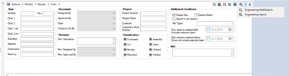

You can find the search tool here:
comment imagecomment image
