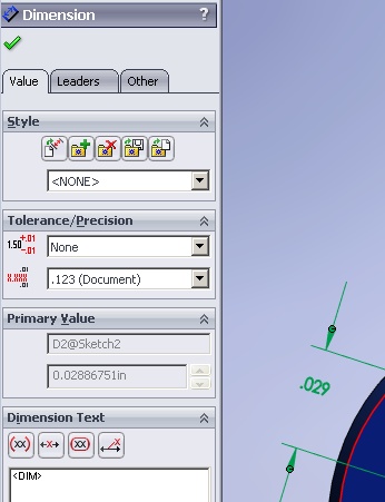

How do I rename a driven dimension in SW2009?
Hopefully someone can answer this one quickly. I want to setup a design table for a mil spec part that I am modeling. It is aset screw, so it will have a few dozen configurations. I want towrite an equation in the design table to control one of thedimensions.
To do this requires a driven dimension. I want to rename it soanyone who looks at this later will know exactly where thisdimension came from. So this is all buildup to my question of...
How do I rename a driven dimension in 2009? It is grayedout!
In the time it took me to post this, I found a work-around. I madeit driving (which overconstrained my sketch), renamed it, then madeit driven again. Is there a more appropriate way?SolidworksSketching

TP 2009-01-29 Best Answer
You have to be in the sketch to be able to remane thedimension.

Either way, I was, in fact, in the sketch.

That's funny, because I can rename dimensions in Sketches, Parts,Assemblies & Drawings currently using SW06.
As far as I know, this is how it has always been.
Am I missing something?

The only time I can't rename is if the dimension isdriven.

Right, my issue is only with driven dimensions. I want toknow why I can't change the name of a driven dimension.

I guess they've assumed (incorrectly) that no one would wantto. At least you found a work around.

Looks like a regression bug, works in 2008 Sp4.

Interesting! I tried it in 2008, and you are correct; this isa change for 2009, for the worse.
Luckily there is an easy work-around and it's not ashow-stopper.

This issue is listed as a Fixed SPR on SP.4 EV
