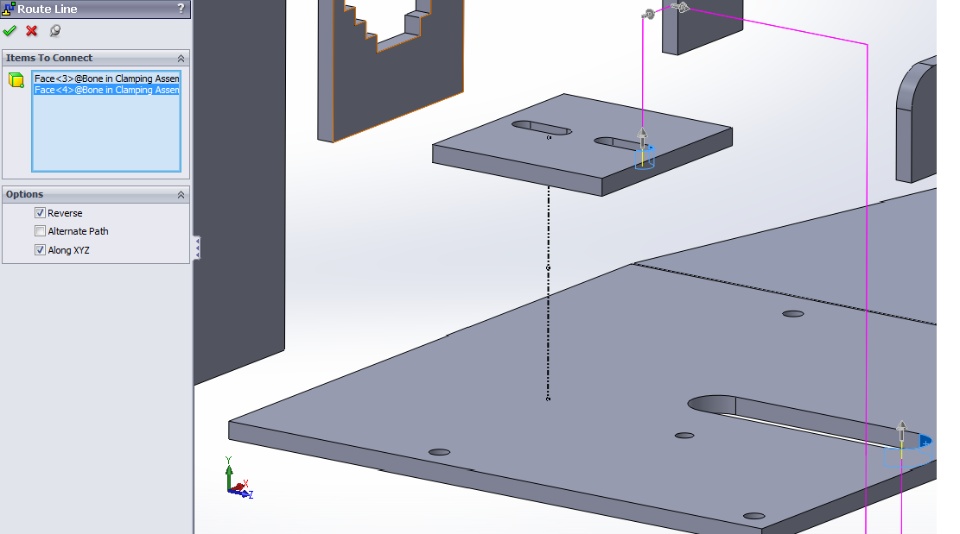

Hello everyone,
I am having trouble eliminating the jog(s) in my route lines for an exploded view. There is no problem if I make lines between concentric mates, but coincident surface-surface mates are a different story (please see attachment). Also, is there not an auto-route-line function? I dug around in the archives for a while, but I did not find what I was looking for.

DG 2012-10-25 Best Answer
Simple delete the generated line and draw your own line while you're in edit sketch mode for exploded lines.

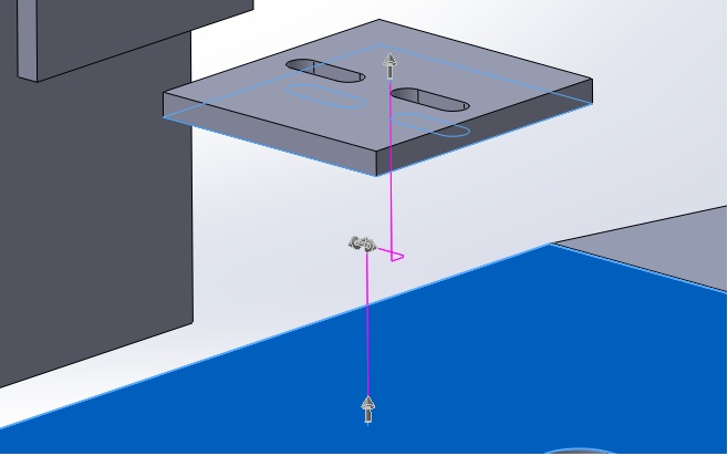

Would you explain a little more? This is my first time using exploded view (so correct me if I am wrong), but it looks like you can only explode along X, Y, or Z. If your model is mated to an axis, and you explode along an axis, is it that difficult to program some kind of auto-route function (I know nothing about programming), say from center of surface along to mating surface along the exploding axis?
Even if that is too complicated, I do not understand why insert/exploded line sketch jogs like it does in my picture; the smaller plate was exploded in the +Y direction, so why does the line jog? Furthermore, I have attached two more pics of route lines that do not make sense to me. SW's explode function is cool, but I need help understanding what is happening.

You can use reverse option. Also try unchecking "along XYZ" and you'll get more results to try.

SF 2012-10-25
The reverse option is checked in "Expl Lines 3" but not in "Expl Lines 2." The point I wanted to make is that no matter what combinations of boxes I check, no combination results in a straight route line. What is up with that?

LB 2012-10-25
look at where the 2 parts are, you picked one arc and another arc that aren't lined up, there no way to get a staight line from what you picked. Sorry doesn't work in the realworld either.

I know you can't get a real-world straight line, but the line goes over the top of the plate - who would do that in the real world?

LB 2012-10-26
all you have to do is click the 3d arrows and the explodeline will come in from the bottom
