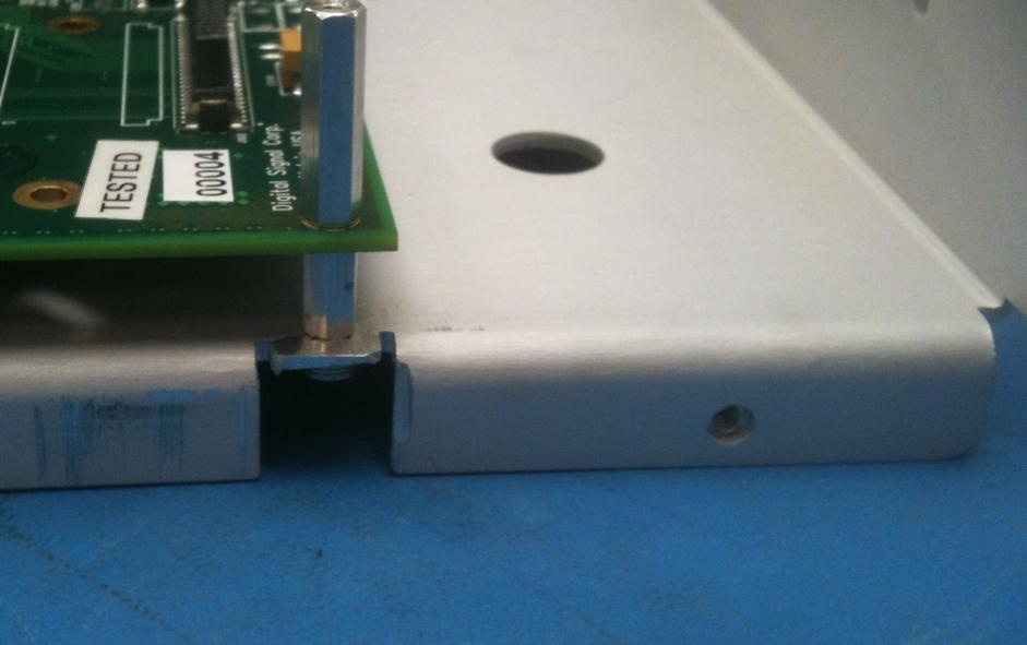

How do I leave a portion of a flange unfolded
How do I leave an area of the sheet metal where the stand-off sits be flat instead of being folded with the rest of the flange.
The target here is for the hole not to be on the sketched bend which will make the standoff sit at an angle rather than being 90 degrees.
Pls see attached pic for reference on how the design intent looks like.
SolidworksSheet Metal
Answers 3
SC
SC 2010-11-11 Best Answer
The simplest way to do this is to go ahead and make the single flange and then cut away to expose the notch and then add a flat area.
Steve
comment imagecomment image
TP
TP 2010-11-11
Similar to Steve, see attachment
DG
DG 2010-11-12
Other way out might be to create two edge flanges
