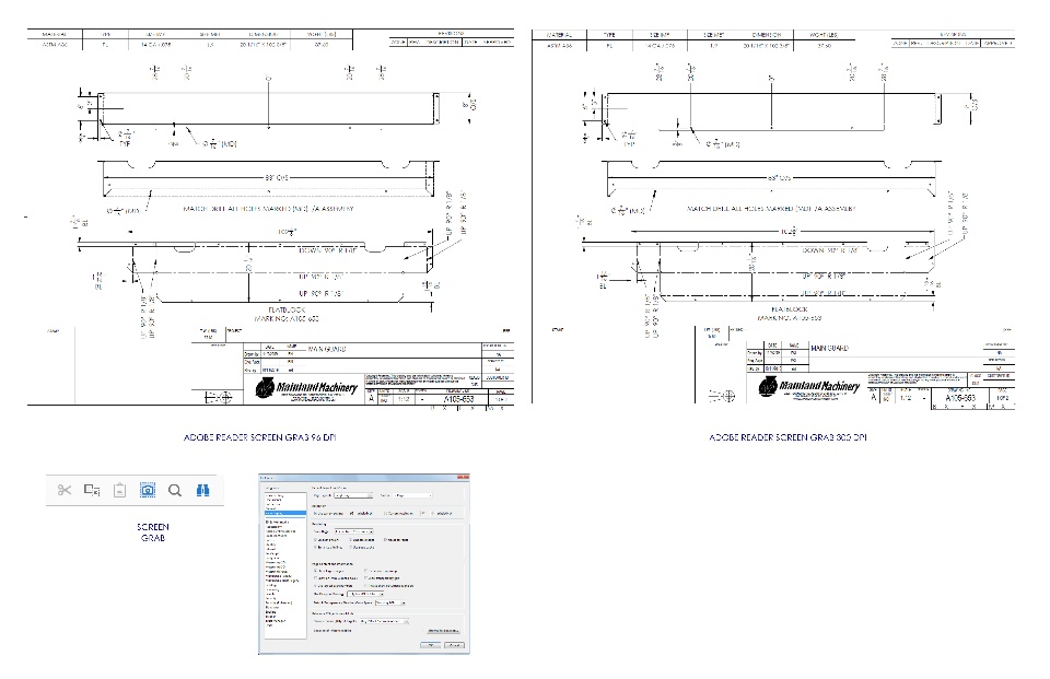

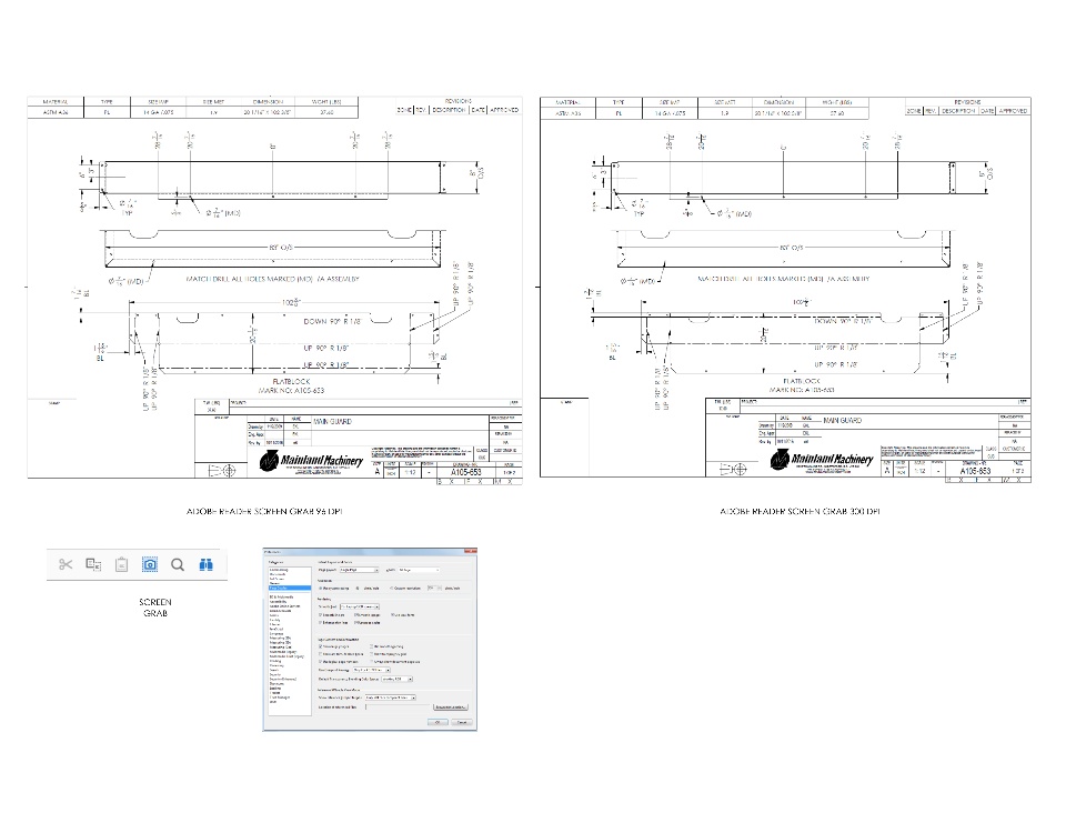

Simply copy paste a screen shot....this is the fastest. You can use MS snippet or Reader snap shot tool...both come standard.
Inserting pdf's as objects behaves temperamental (unpredictable) so I would not suggest that route.
The image resolution doesn't seem to vary too much from either copy paste option. Quality depends more on original screen resolution.
