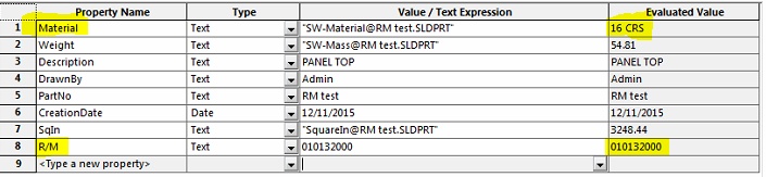

How do I create an if statement macro that can add a new custom property?
How do I create an if statement macro that would take my custom property material and add a new custom property line named R/M with a material code.
Ex:
If material =16 CRS
Then R/M = 010132000
I would like the property R/M to be added by the Macro.
SolidworksApi macros

<p>Option Explicit</p><p>Sub main()</p><p>Dim swApp               As SldWorks.SldWorks</p><p>Dim swModel             As SldWorks.ModelDoc2</p><p>Dim swCustProp          As CustomPropertyManager</p><p>Dim ValOut              As String</p><p>Dim ResolvedValOut      As String</p><p>Dim wasResolved         As Boolean</p><p></p><p>Set swApp = Application.SldWorks</p><p>Set swModel = swApp.ActiveDoc</p><p>Set swCustProp = swModel.Extension.CustomPropertyManager("")</p><p></p><p>swCustProp.Get5 "Material", False, ValOut, ResolvedValOut, wasResolved</p><p>If ResolvedValOut = "16 CRS" Then</p><p>    swCustProp.Add3 "R/M", swCustomInfoText, "010132000", 1</p><p>End If</p><p></p><p>End Sub</p>
CC
CC 2016-09-12
I just tested and it works - see the full macro
<p>Dim swApp As Object</p><p>Dim swModelDoc As SldWorks.ModelDoc2</p><p>Sub main()</p><p></p><p></p><p>Set swApp = Application.SldWorks</p><p>Set swModelDoc = swApp.ActiveDoc</p><p>Dim cpm As SldWorks.CustomPropertyManager</p><p>    Set cpm = swModelDoc.Extension.CustomPropertyManager("")</p><p>If cpm.Get("Revision") = "B-01+" Then</p><p>        cpm.Add2 "Test", swCustomInfoText, "1234"</p><p>End If</p><p>End Sub</p>

LL
LL 2016-09-12
it works thank you so much do you think i could use this macro on many different parts with different materials? so more if then statments in the same macro?
DG
DG 2016-09-12
Yes. You can use something like this (changes as required, just added random values)
<p>If ResolvedValOut = "16 CRS" Then</p><p>    swCustProp.Add3 "R/M", swCustomInfoText, "010132000", 1</p><p>ElseIf ResolvedValOut = "17 CRS" Then</p><p>    swCustProp.Add3 "R/M", swCustomInfoText, "010133000", 1</p><p>End If</p>
