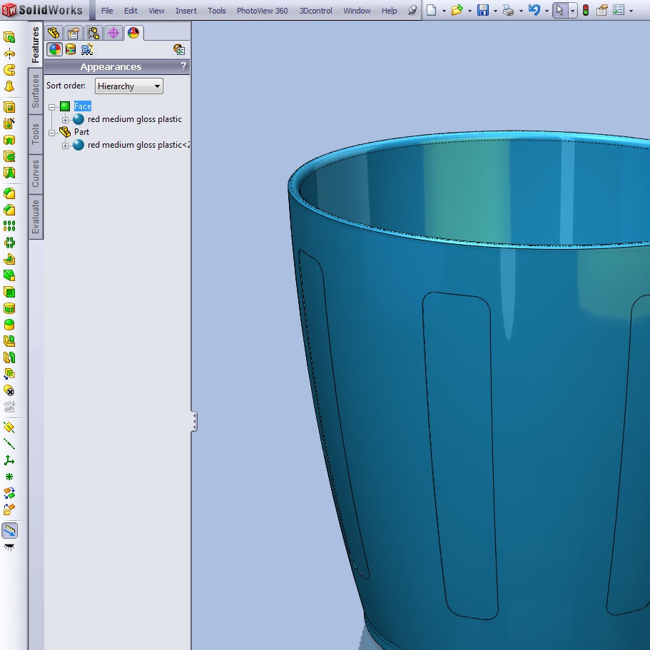

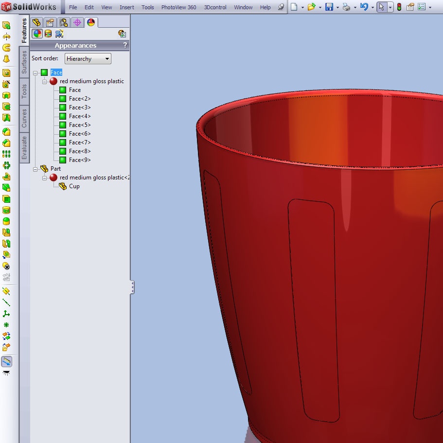

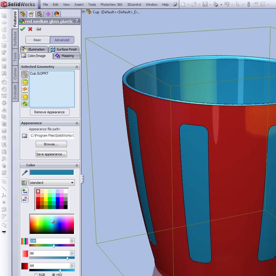

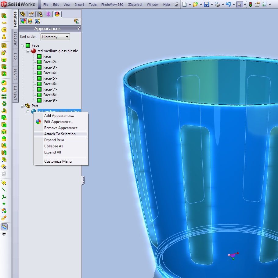

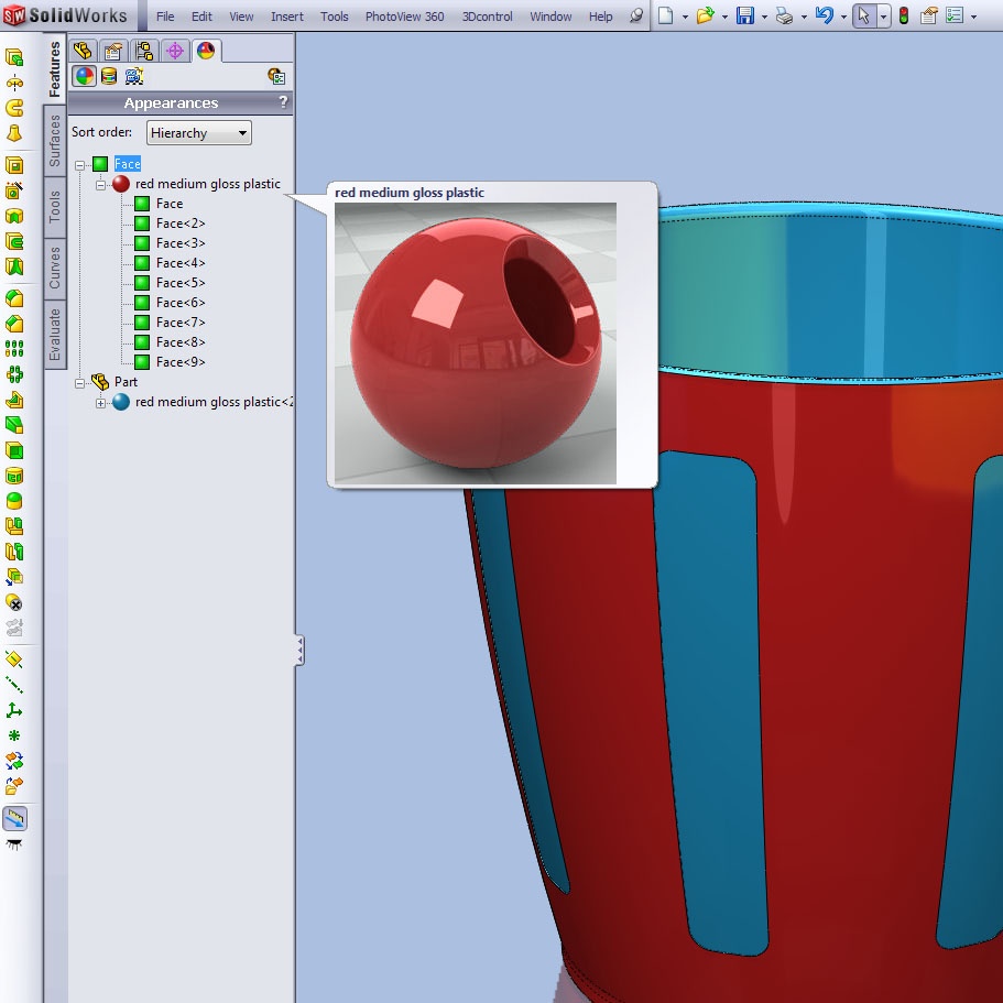

Hi Jeff,
You can attach an already applied and tweaked appearance to another object by RMB clicking in the FM under appearances and selecting "Attach To Selection".
In the enclosed screenshots I'm showing the same apppearance attached to the part itself, and also to some faces. I've modified the color of the part through the appearance editor, and then applied that color change to the faces by selecting the face appearance, and then RMB clicking on the now modified appearance and selecting "Attach to Selection". The modified appearance is now effectivley copied to the faces.
