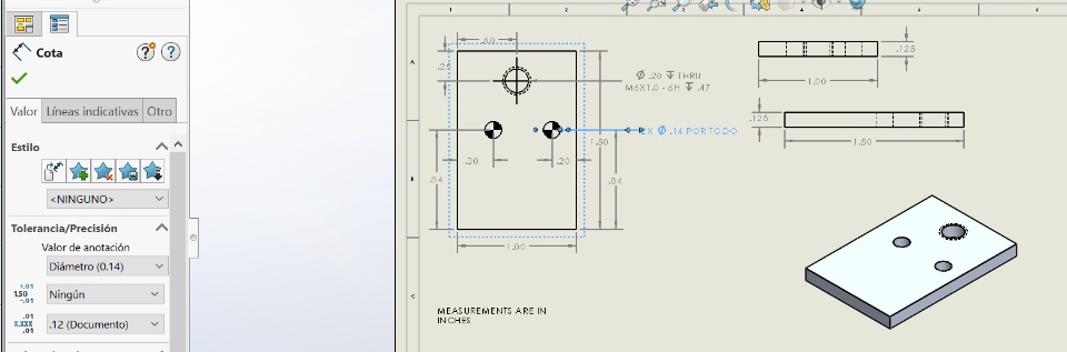

I feel more comfortable using SolidWorks in Spanish, but I need to keep some notes and texts of the drawings in English. For example, with the dimensions of a hole, I need it to say "THRU ALL" and not "POR TODO".
Is there a way to change the dimension text to English, in place of Spanish, automatically?

I don't think so, other than overriding the Spanish text and inserting the English text.

I have solidworks language in Spanish right now, and the location you say is \solidworks\lang\english\
but even so, the dimension text is still in Spanish. Should have worked, but maybe the solution path is another one.

If you look at SolidWorks > System Options > Hole Callout Format File, what path is being used?  The default ones are stored in:
\solidworks\lang\\calloutformat.txt
...so I'm wondering if you could point to the English language one rather than, presumably at the moment, the Spanish one?
