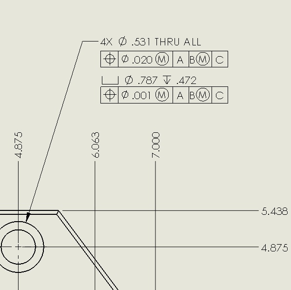

How do I attach different Geometric Tolerances to different line items of a Hole Callout?
OK, so I have already discussed this with my VAR and she didn't really have a good solution.
Basically, what I want is the following:
What I had to do to show this functionality was:
1) Create the Hole Callout, add some blank lines between the two line items.
2) Create and attach the bottom Geometric Callout (.001)
3) Create the .020 Geometric Callout and place it in space
4) Drag the Hole callout over the .020 Geometric Tolerance until it is in place.
5) Select both items (The Hole Callout and the .020 Geometric Tolerance), Right Mouse Button, and select "Group".  (This groups them together and allows the .020 tolerance to move around with the hole callout)
I know that this is a SHCS Hole, but I am just using this as an example.
We have many very tight tolerance blind counter bores with very loose tolerance thru holes.
I know that I can create each hole separately and then use the hole callout to call each hole out separately.  But how can I have the functionality of the above and have it all nicely "Attached"?
Is there a better way?
I am using SW 2015 SP3 on Windows 7 64 bit
Is this functionality available in a later release of Solid Works?
Thanks in advance...

So, based on the bevy of responses , my guess is that the way that I did it is the best way for now.
I will be putting in an enhancement request for this functionality in the future.

Hello Dan,
You could call out the TP of the CB and like you have it and then cross section the hole and make the CB another datum
comment imagecomment image

This might also work to keep everything linked and displayed as one element (I'm working from memory, so I didn't get a chance to test this out):
1) Create one hole callout.  Delete the second line.
2) Create a second hole callout.  Delete and remove the first line.
3) Create a Note annotation.
4) While editing the note, on the first line, select the first hole callout.
5) On the second line of the note, create a GTOL within the note using the GTOL button in PropertyManager.  It creates a Feature Control Frame in the same way as Geometry Tolerance command, but the FCF is embedded in the note.
6) On the third line on the note, select the second hole callout.
7) On the fourth line of the note, create your second GTOL FCF in the same way as above.
8) Accept your note.
9) Select each of your original hole callouts and hide them.

I have the same problem as you @DP ​​​​​​​
I do the same trick as you do. Sometimes use two/three hole callouts to the same hole. Each HC is for specific diameter and then I add feature frame. It's ugly but all links are maintained.
This feature is is needed... simply feature frame that we can add in side hole callout
