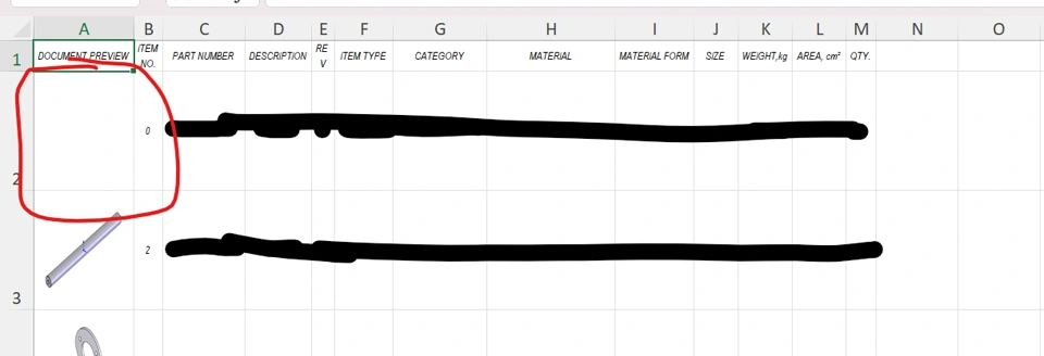

As for adding the row with the active data, I know how.
I can't find a solution for displaying a preview of the active assembly in the 'DOCUMENT PREVIEW' column.
there is a macro out there that will do that. I think I found it in this forum or the cad community forum search for this "bom export.swp"
Depending on your SW, when you export a BOM, there is an option to include thumbnails of the model. So have you tried this?
If this option is not available then, try following macro by @AJ
You may need to rebuid and save the document with no preview.
