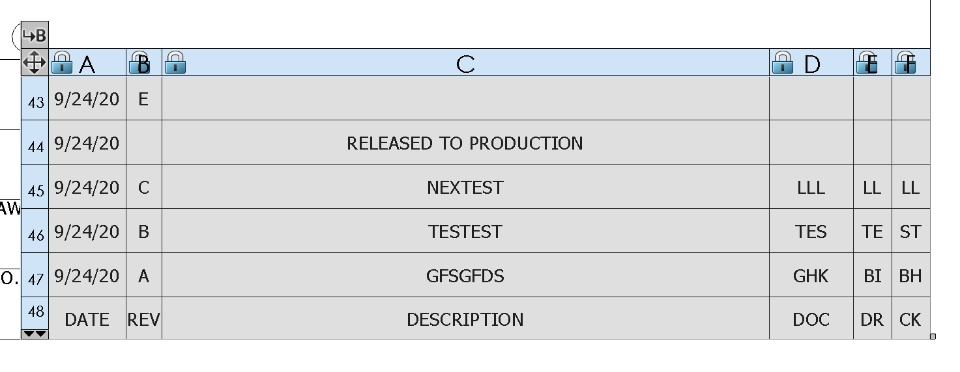

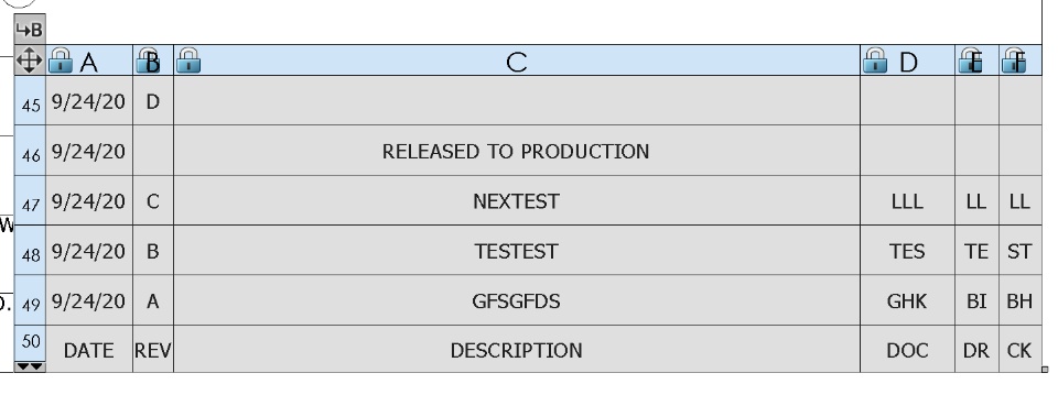

This code gives me the row, which includes today's date, and the "RELEASED TO PRODUCTION" description. Unfortunately, it also increments the revision, so that the next revision skips a letter (since this rev is blank).
Is there a way to do this?
without the next revision being Rev E?

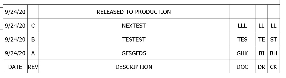

If I manually add a row (LMB top row - insert: row above), then type in the info, the rev stays correct, like this:
Any help would be appreciated. I am hoping to use this code to automate production release of multiple drawings.
