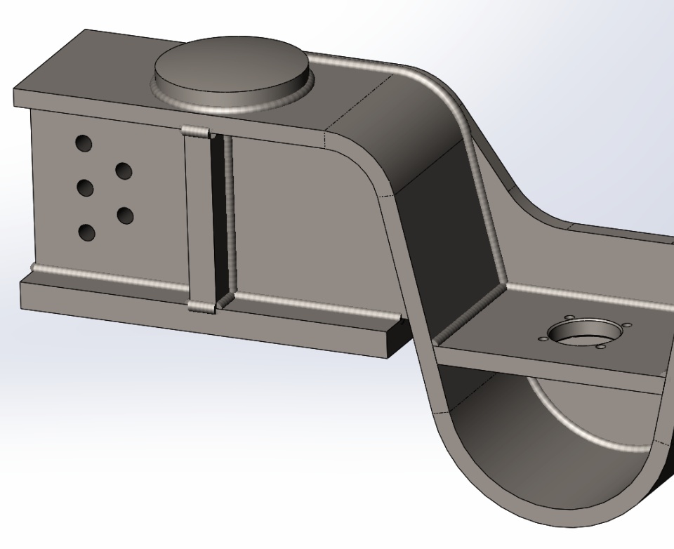

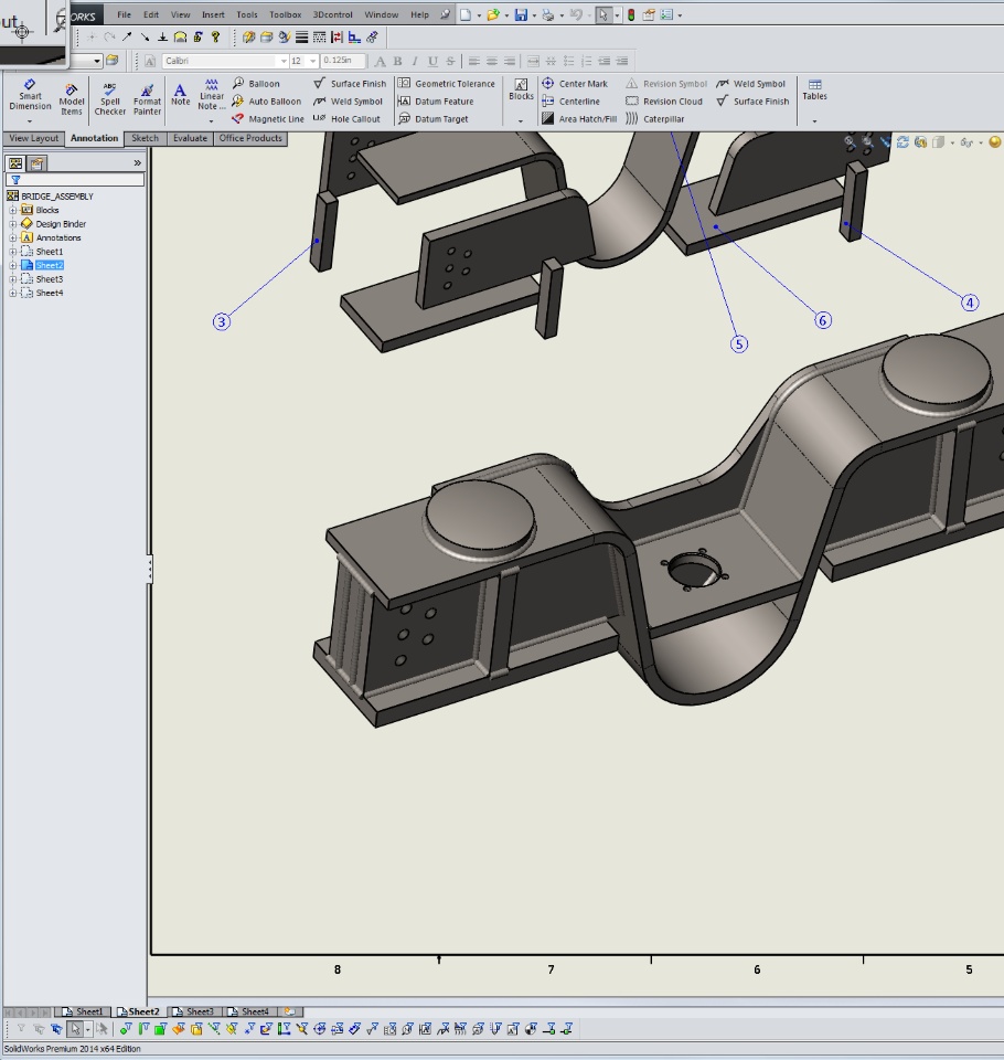

In my assembly, I am using the "weld bead" feature to show where the weld beads need to be placed.  My goal is to display my welded assembly in a drawing using multiple 3D views showing details of where, and in what order, the welds need to be fabricated.  I am partially able to do this (see attached Assembly & Drawing), however, I would like to at least change the appearance of the weld bead so that it will stand out (e.g. modify their colours so that I can easily discriminate between different welds in my notes...such as the "red" welds are made first, the "green" welds are made second, etc.).
Intuitively, I have tried to drop appearances onto the weld, as well as dropping appearances onto the weld listed in the "Weld Folder", but nothing works.  Does anyone have any ideas on how to get at, and modify, the appearance properties of weld beads?

Hi Lucas,
AFAIK you cannot do this in assemblies using weld beads.
But if you use a weldment part and put a Fillet Bead on it, then you get another solid body in you multibody part and you can change the appearance of that body separately.
Not what you are after exactly, but I hope this helps,
Eddy

It does look like what I want to accomplish, however, I assume I would have to save the Assembly as a Part, and then apply the Fillet Beads.  This seems rather cumbersome, but I suppose it is a work-around to SolidWork's deficiency in this area.
It would seem much simpler if SolidWorks could provide access to the Weld Bead Appearance (with Mapping if it isn't too much to ask) in the Assembly.  I could even live with the non-realistic but simplistic cylindrical shape of the weld (since I am able to control their apparent diameter so they don't look too funny).
