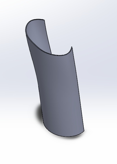

Hi all,
I have a curved part obtained by a loft between different circles. After I made a shell in order to obtain a simil hollow-cylinder shape.
I attached it to the question.
Now I would like to make a holes pattern on it. I wanted to use "fill pattern" features but it seems not possible.
Do you know a way to define a holes pattern on this part?
Thanks
