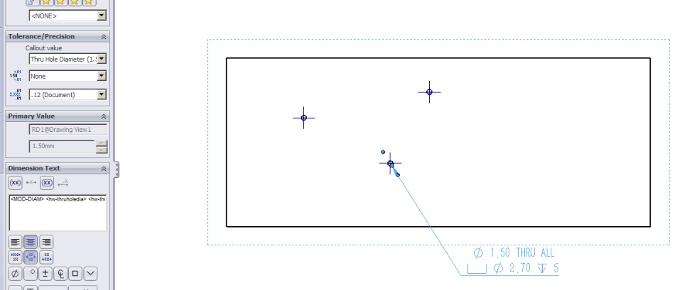

How can I set up for Enable/Disable for hole callout.
Hello Dear,
    Could you please help me.I lost function .Please you see the picture i have pattern hole.But when i use "Hole callout" In Dimension text it do not have .
How can i do.
Please!!!!
SolidworksGeneral
Answers 1
RC
RC 2015-07-09 Best Answer
Hi,
What Standard for the HoleWizard hole did you add as some don't have the number of instances.
