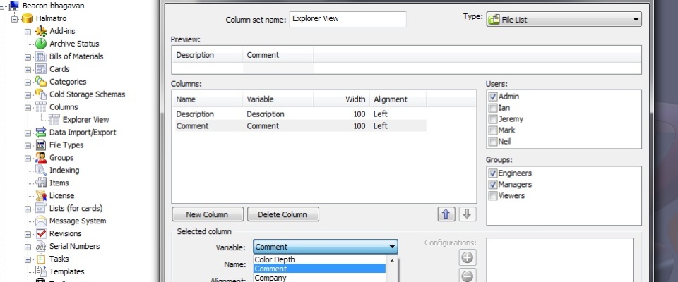

How can i prevent user (not group) from seeing file
How can i prevent user (not group) from seeing file, and how can i view comments of files in another column (show comment column)
Thanks for your help
Answers 6
SF
SF 2011-02-09 Best Answer
Hi Do Le Vu !
1) The only way to achieve this is to put that file into a folder and remove the folder permissions for the users.

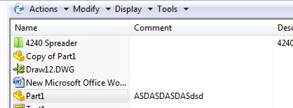

2) You meant Version comment to be displayed on the vault view ? Attached the pic for your reference.
To do this Please open the Columns in the Adminstration, Add a new column called Comment and Give the appropriate permission to users to see this column.
Attached pic for your reference.
Cheers !
Raghu.
