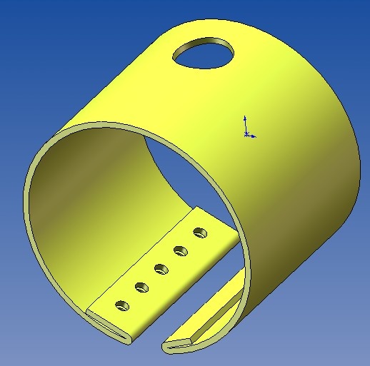

I am looking for a better way to create a hem on a cylidrical part. The attached part started from another solution that Pankaj set up for me on another posting, but now I want to add 2 hems and some holes. We are using is a Polymer material that we first water jet cut (including ALL the holes) and then form by hand. The attached files show what I want to end up with (well sort of). The hem tool does not work on a curved part so I used the Edge Flange tool. This somewhat works but results in the hems being flat. Having a flat surface did allow me to easily add the 5 holes. Is there a better approach to hems and holes on this part? Thanks for all the support

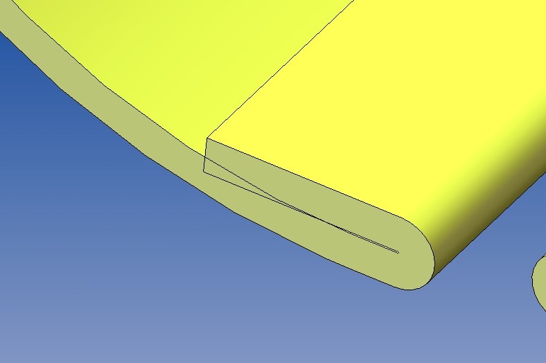

Allen, I was able to create a hem on your part by editing the original sketch and putting a small tangent line at each end point. However, this did have a negative effect on the other features. I'll keep playing with it and keep you updated.

I never thought of the idea of adding on a small amount in order for the hem tool to now work. The only thing that could be a problem would be when you increase the width of the hem you do get to a point where it does overlap (see image). Of course I never said how long the hem had to be in my orginal post. Not sure if you had a chance to pull up Kenneths idea (another approach that works well).
Now for part II... adding holes. The best way I thought of to do this was to add a plane that is tangent to the OD and use this to place the hole. I linked up the plane with the center of the hem by drawing a construction line that goes through a midpoint of the hem. (see attached) As you would imagine it will be critical for the hole to move with the hem as I change the overall sweep angle of the part.

Try this for the holes, based on mr barrantine's method.  the sheet metal doesn't seem to flatten if you put holes directly on a bend. So, unbend the part, then with the hole wizard place the holes.  The holes are located from the edge of the hem (linked to the base sketch dimension) and are symmetric about a construction line located at the center of the hem bend.  This seems to keep them aligned.
