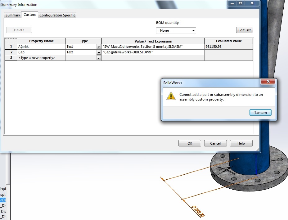

I have an assembly which has a subassembly also. And in that subassembly, I want to take a part's sketch dimension to the drawing of main assembly.
When I am trying to make custom property from main assembly, It gives me an error.

DG 2014-04-25 Best Answer
Create an equation and link that to the dimension you want. Then link the custom property to that equation
