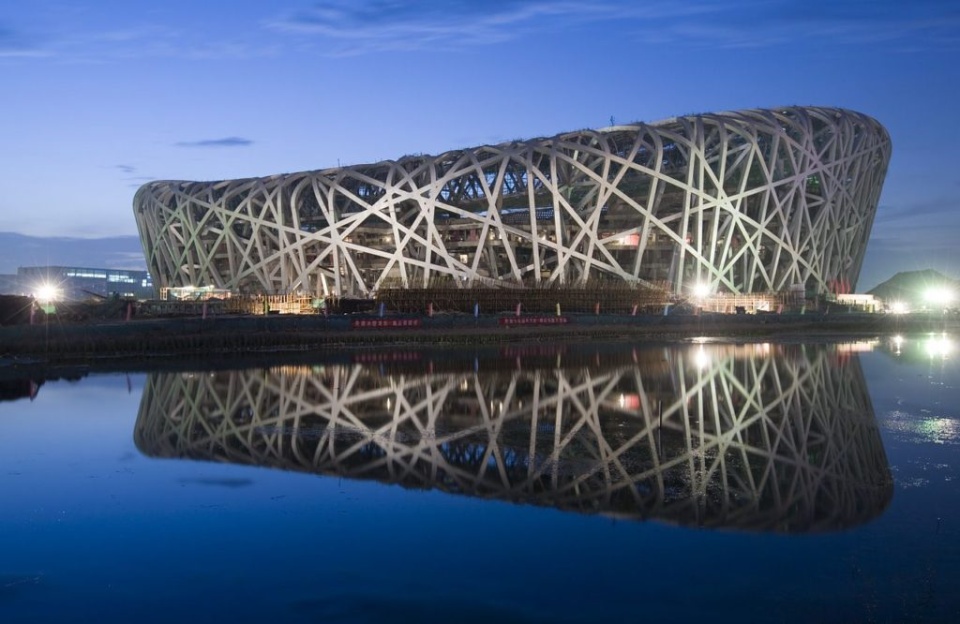

How can I get a surface like this?
First of all I apologize if the question does not go in this section.
I'm looking to finish an object similar to a bird's nest, like this:

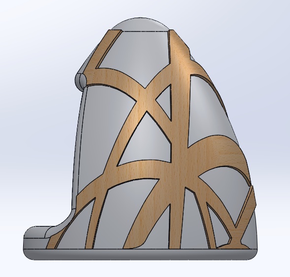

Doing research I found the tool "wrap", but the "branches" of the nest are not uniforms, and look like this:
How can I get the width of the branches to remain uniform? Thank you!

KC 2017-12-24 Best Answer
Hello,
Winging it w/o much info, but try:
  1. Create a sketch on the "thing" you wrapped with and covert all of the edges
  2. "Project curve" this sketch onto your egg
  3. Extrude using this sketch (EDIT: You may have have to clean/close the sketch first for the Extrude to work)
Cheers,
Kevin
RE
RE 2017-12-25
Hi Albert
Could you use a circular profile on a sweep and then get the intersection with your surface?  Whilst not perfect I imagine it would be reasonably close
Just for fun I used a Design Table to produce a random data set of 3 points, which defined a plane.
Using Sketch Tools > Intersect Curve to get sweep path, I then cut the sweep with the original surface.
I then inserted all the configurations into a nest part, with this simple macro

Of course these are all separate bodies so the next stage is to combine them all
As they are mostly disjoint to each other it's best to subtract them from a solid block first
before subtracting the result from the original block
It takes a while but now we have access to just a couple of faces to offset and thicken
happy days

Cheers Dave, this configuration pattern technique is pretty cool.  I developed it for making curved staircases, where the normal pattern options were a bit tricky to deal with.  It works in both an assembly or part, in the past I used Design Tables but I'm getting to grips with the api so hopefully I'll have something soon(ish) that will make it a lot easier
