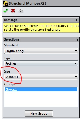

I have a Weldment assembly - lots of  structural members in the tree Named Structural Member 1/2/3 etc....
When you go to Edit Structural Member you can change a weldment profile:
Do you guys know how to get the structural member Size (circled above) via API?
Any ideas or links to similar topics very appreciated.

Check WeldmentProfilePath in API help files.

Deepak, its not very clear to me how to get to that property. I can get a structural body name using the swBody feature (im using drawings to get all bodies)
Any help here?
Thank you.
