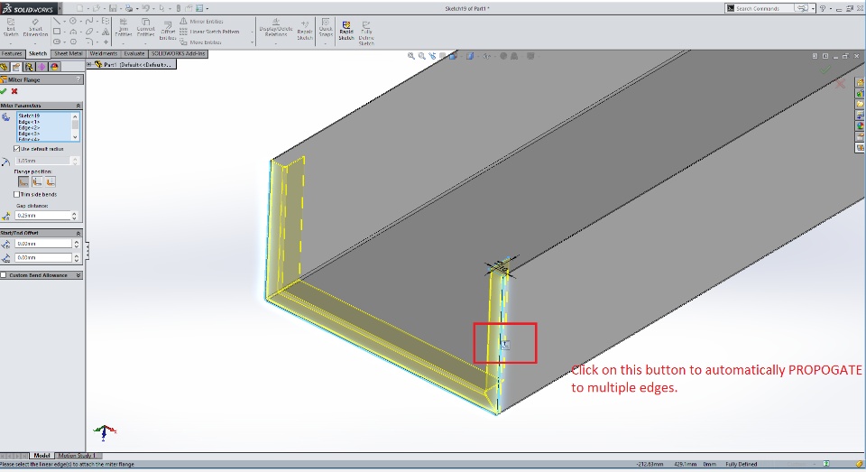

Hi There,
I need helps to solve SW sheet metal problems.
By the way, how can access "propagate" command during miter flange operation?
Thank You,
SC
SolidworksParts And Features
Hello SC!
Click on the button shown in the attached image to PROPOGATE in Miter Flange Command.
