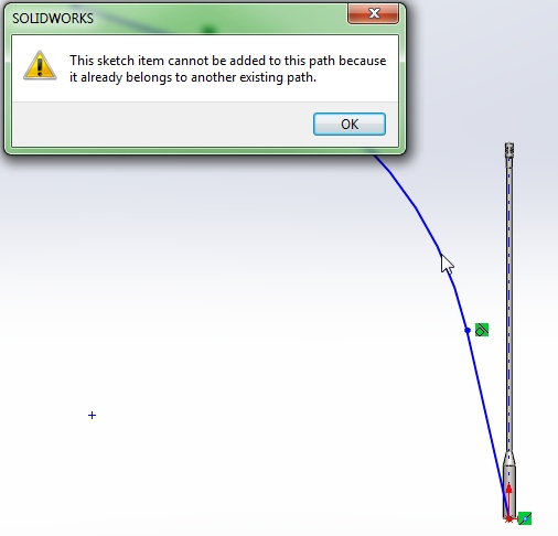

I have a sketch that I need to control the path length.  The path dimension holds promise for me, and in trying to learn it, I created a path that is not complete.  So, I deleted the dimension and tried to recreate it selecting all of the desired entities.  I get this message:
Where can I find reference to the "existing path" and how can I delete it / modify it?  In my case today, I will simply delete the sketch and recreate it, but I am confused about what a path is and where else it might be used and how does one know that it exists and can it be modified... etc...

Right click on the path and hit delete or modify path, that will delete the path, not the lines.

I noticed if you delete an old path length dimension and then try to start a new path length dimension, if your first click is on one of the entities from the original path then it will pop up the same old path length dimension that was deleted (you don't even need to select all of the entities again). So just as you observed, somewhere the path is still being stored even after the path length dimension has been deleted.
I think to get rid of that saved path you can right click on one of the entities from it and pick "edit path". Then clear all of the selected entities in the selection box and check out. You'll get an error message about the new path not being good, but just say ok twice and then it appears you can make a new path with those entities.

Or you can just right click on a line in the path and hit delete, deleting the path length doesn't delete the path, only the dimension.

Oh yeah that is weird, I would have expected that to actually delete the entities, but it just gets rid of the path assignment. You can also just left click on one of the entities and use the delete key.
