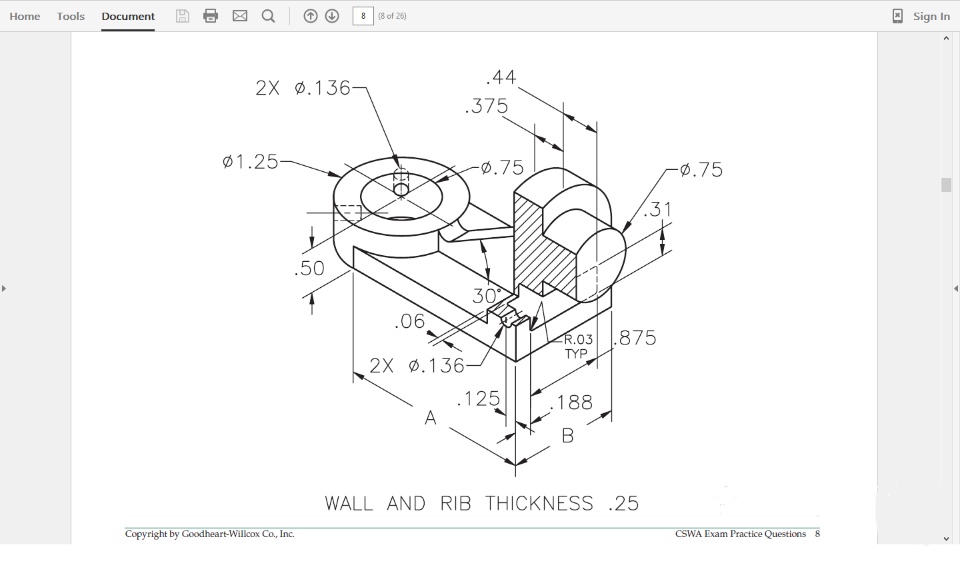

How can I create this rib?

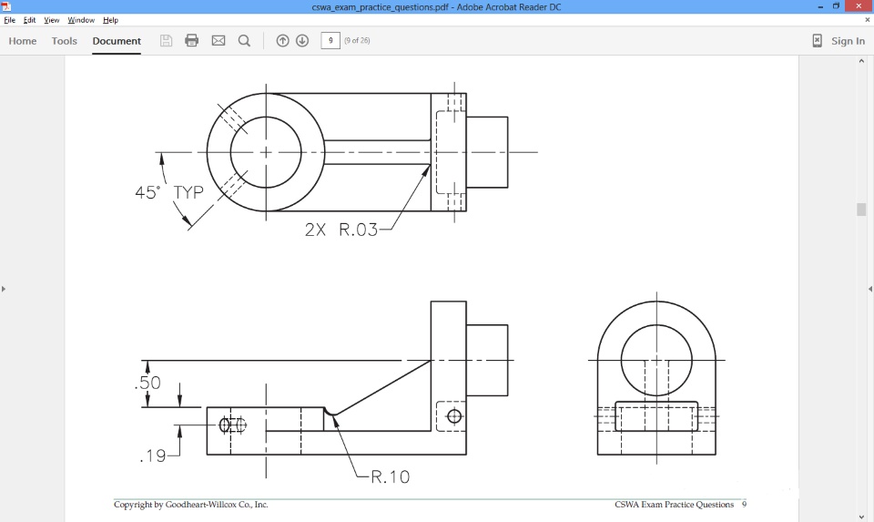

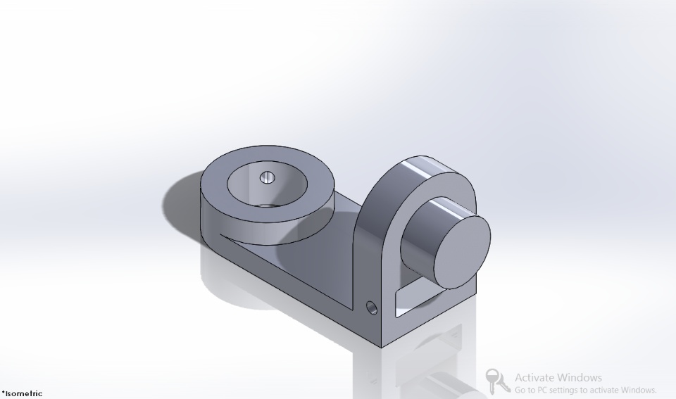

I am having trouble making the rib feature at the center of this part. I have everythong else completed as shown in my model below. Since it is not just a stright rib I can't seem to use the rib feature. Basically that little R.10 arc at the end of the rib is causing all the trouble. I have tried a few different methods including rib, extruded boss, and even swept boss. I got close to how it should be but couldn't get it perfect. There has to be an easy way to do this, right? Can anyone give me some guidance on creating the feature? Thanks.

From the look of it.
Make a sketch on the plane that is in the middle of the rib or make a new one there. Use the 0,5 dimension and 30°. Use the rib tool, make sure it goes in the correct direction. Add the fillet last.
SF
SF 2015-06-17
Oh wow, that worked. I thought about using a fillet, but I didn't think it could be used that way. Thanks.
