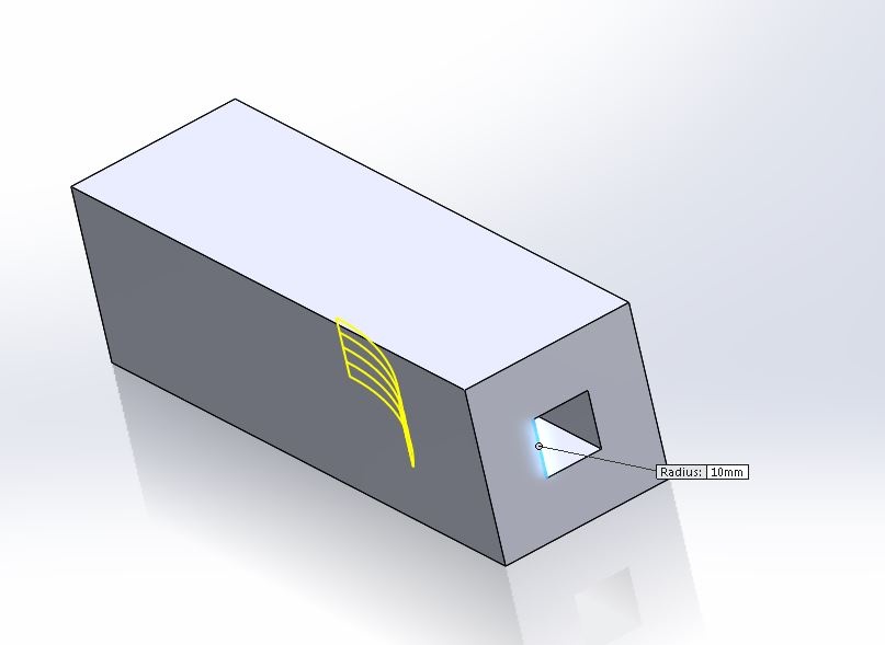

I have a feeling this is an easy answer but for some reason I haven't been able to get it. How do I change the "center" point of a fillet? For example, in the situation below, I''d like to add a 10 mm fillet to the corner; however, I don't want to "take back" the material from the corner. Adjusting the center location of the fillet would like in the second picture would prevent this. Is this possible?

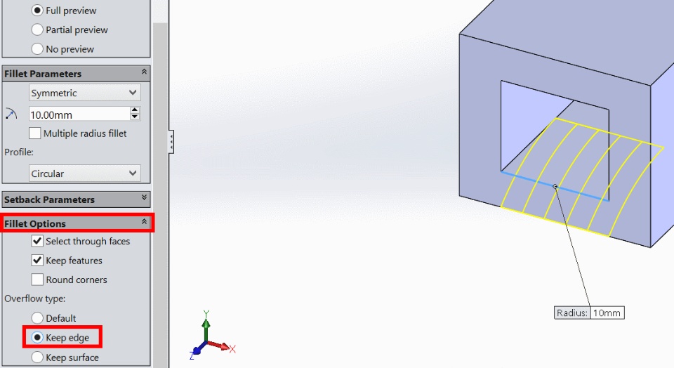

Hello,
     Have you tried selecting the "Keep Edge" option under "Fillet Options"? (see picture attached)
     I'm not sure if this is the result you're looking for.
