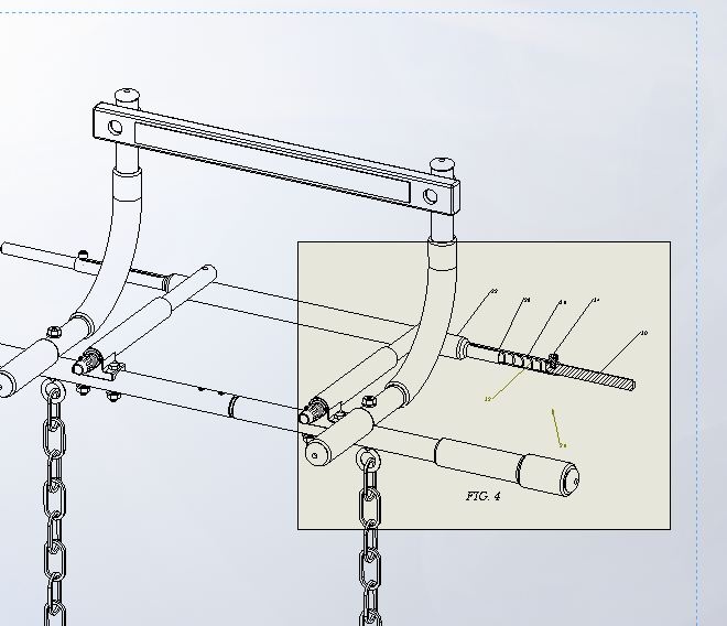

How can I resize the drawing view to be close to the paper size?
I have an assembly drawing where I want to zoom up on a detailed area. I don't want the rest of the assembly to run off the page. You can see in the image below the drawing view is way bigger than the paper size (white rectangle). My goal is to shrink that drawing view down, but how?

I don't think that is it. That will make the paper larger. I want to change the drawing view size. The image and the paper is the correct scale. I want to be able to have white space around the border. I don't want to see the bits of the assembply that don't fit on the paper.

Brent, you need to crop the view.  In the menu, it's under Insert, Drawing View, Crop.

Change the scale like Scott said and then add a detailed view and change the scale on the detailed view.

Crop was totally the correct way to do it. That solved my problem. Please see the results below.
That is what I wanted. :-)
