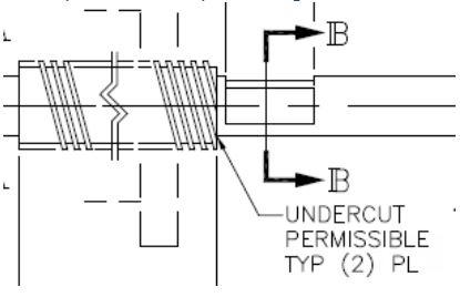

Your image does not show any specification for the thread (the critical information), but going only by the image it appears to be Square Threads - if you want those in drawing you will have to model in part (or sketch in drawing).
Are you sure those are even threads? (If they are - the representation has been simplified.)

Hello J Mather,
Thank you for your reply. even i was not sure about this type of thread so i have asked for more information from my client.
if i will get more clear information i will update you as well.
Thanks once again.

In addition to appearing to be square threads, it looks to have multiple leads, at least two.
