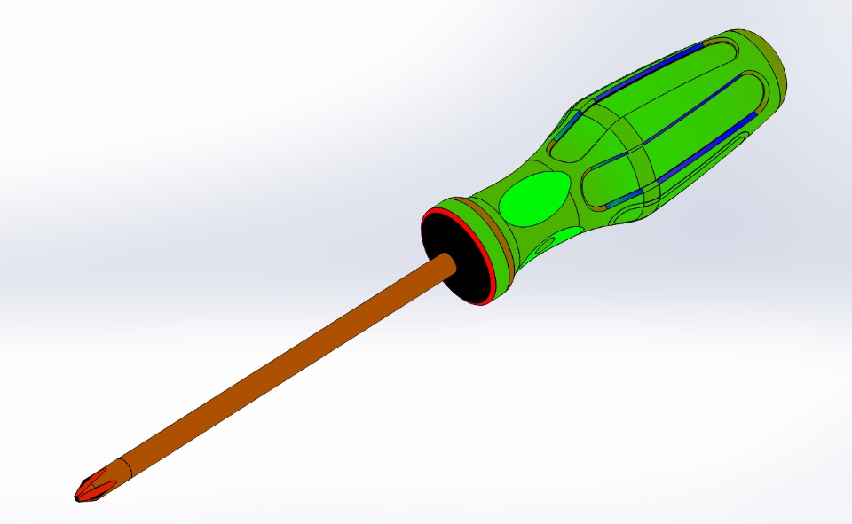

I'm trying to model a screwdriver as accurately as possible, to get some practice in the semi-advanced modeling features SolidWorks provides. I'm stuck at creating the little bumps on the grip, and I was hoping someone could offer some advice.
As you can see here, the handle of the screwdriver is pretty detailed, with a lot of different curves. Notice the indented parts of the handles consist of three different curved parts.
Also, the indents are not parallel to any of the standard planes, but are angled. Two of the indents are parallel to Plane 2, which is on a 35 degree angle from the front plane.
So far so good. What I'm trying to recreate is this:
These little bumps are about 2mm high, including the rounded top, and 1.5mm in diameter. So far I haven't been able to find a suitable solution to recreate them in such a way that they all are approximately equally tall, and follow the curve of the surface.
Any help would be greatly appreciated

AT 2016-03-01 Best Answer
Hey Hj,
Search up Variable pattern option. Take a look at this example, that I have attached here.
Hope this helps,
Alen

SF 2016-03-03
Hey Alen,
Sadly, it didn't. I still had some problems with following the correct curves. I fixed it by adding the bumps as a texture in Keyshot. Thanks for the advice!

CB
CB 2016-03-03
Hi HJ,
Keyshot would be good for visualising this, but you wouldn't be able to manufacture the product that way.  So still need to get the bumps into SW somehow.  I'm curious too - anyone else know how to do this?

PS 2016-03-03
I had a crack at it.. but I did not add draft for the nubs.. and I'd probably spend more time at it if it were for real... anyway.. a example doing it..
comment imagecomment image
