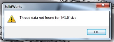

Every time I open the Hole Wizard this message appaers.
I've added a new type of thread but I didn't touch the DIN tapped holes. What has gone wrong?
Also I need a M63x1.5 thread and I can see it it under Thread data but not under Sizes. How can I use it as a tapped hole?

The error can appears if the syntax is not correct
>In the 'Sizes' table, the 'size' box should have the pitch added to it,and its syntax is 'size-pitch'
>In the 'Thread data' table, the 'full size' box should have the same text of  the 'size' box in 'sizes' table.

Thanks, but this was all filled in correct. Could it be something else?
KL
KL 2011-05-18
Can you post a screen shot of the data sizes. The database is very picky on syntax.
Are you sure the correct Hole Wizard/Toolbox database is being referenced?

Ok, but when did you upgrade?
I ask because I have run into having old toolbox/holewizard files and they needed
to be upgraded through tools>options>system options>holewizard/toolbox>config

Does the M2 thread show in the HW selection list?

Yes it does. But I'm using the DIN standard.

Then maybe you are using a part that was defined in another standard.
Try changing the standard to say ANSI or ISO.
You can do this in Tools>Options>Document Properties>Standards.
