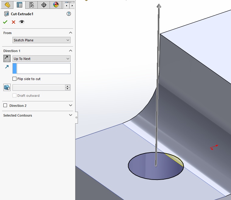

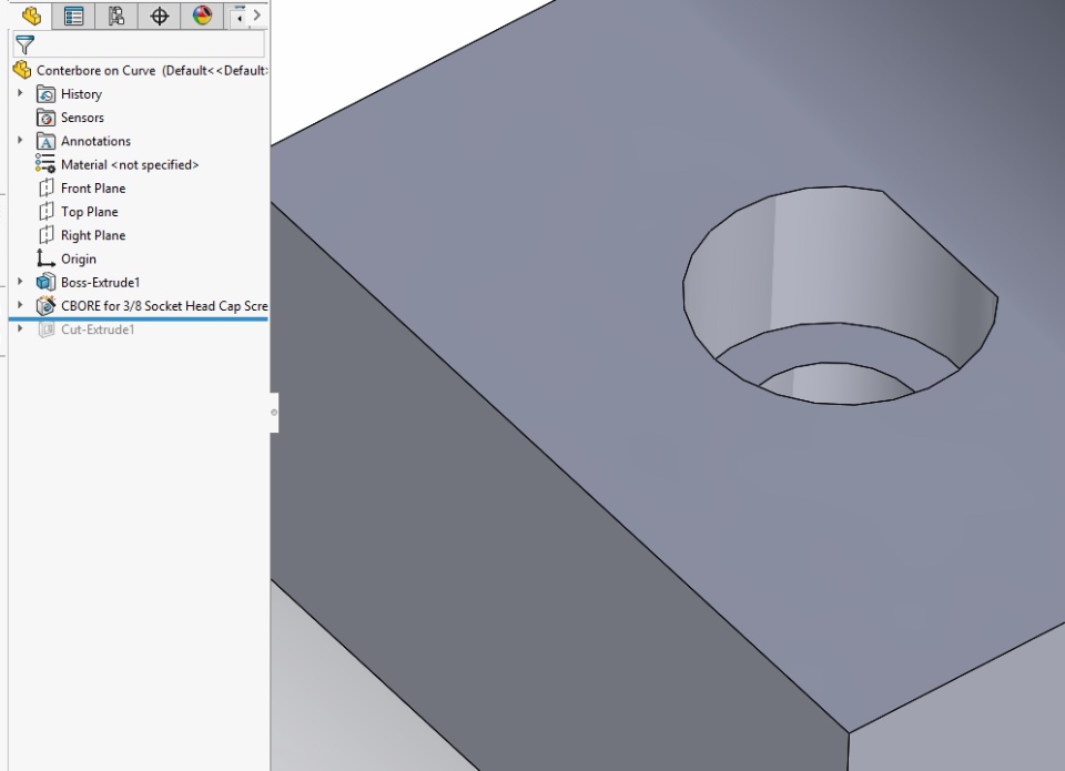

I have a part where a counterbore intersects a corner fillet in a step on the part. When I create the counterbore using the hole wizard on the surface of the part, the portion of the counterbore that should cut into the curved face of the fillet shows as a sharp edge. It does the same for regular holes. The Hole Wizard feature will not make the cut above the sketch plane and there is no option for "Though All - Both" in the hole wizard

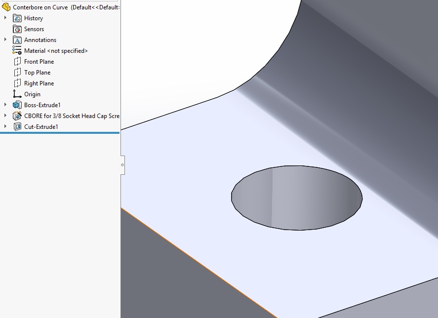

The only way I've been able to clean up the hole wizard feature is by creating another Extruded Cut feature, making a circle in the sketch coradial with the top edge of the counterbore, and extruding up to the next surface.
Is there a way to get the Hole Wizard to natively remove the material above the sketch plane?

Well, I know this is not what you are looking for, but how about putting the holes on the model before the fillets. That's the way it  should be anyway. If you dimension between a hole and an edge created by a fillet, that's a big parent/child no-no. Fillets will go around the hole, they won't skin over it like you show. This is why we have a history based modeler, and yet we don't use it. Feature order with fillets at the end should be standard operating procedure for everyone.

Never mind.  I have been schooled.  Use the Keep Surface in the overflow properties and it all works out.  Thanks Matt for pointing that out.   You know, I think that I had seen that before....I just forgot about it.

Ok, I'm guessing that this first solution is not the one you're looking for. Scroll down, there's an option in the Fillet feature that takes care of that inconsistency in the fillet shape.
The "Keep Surface" option will smooth out the fillet and extend the face of the hole the way I'm guessing you want it to. In this case, the "keep edge" is the default functionality. I wouldn't extend the problems by developing additional work arounds with planes and other additions to the hole when the real problem is just the feature order.

, yes, I agree, there are times where you can't avoid the situation the OP demonstrates. But this isn't one of those times. When it does happen, you could do something simple, like use Delete Face to remove that overhang.
Here I created the situation and fixed it with a Delete Face. I didn't mention this earlier because it's just another workaround for something that could be avoided more efficiently another way.
