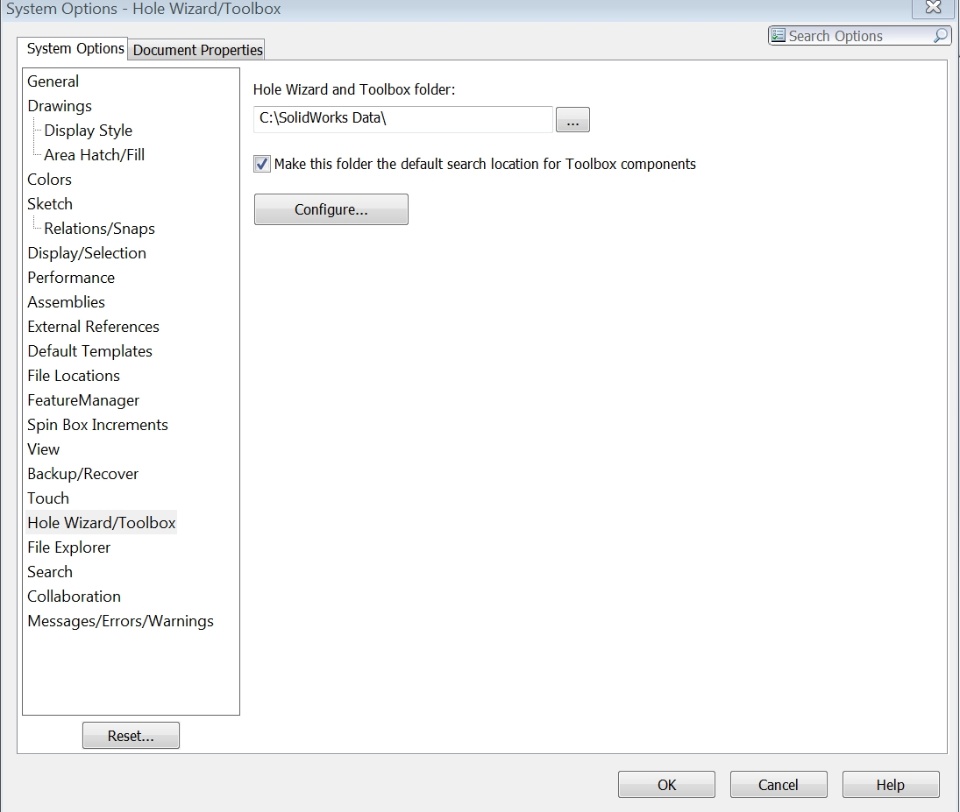

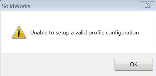

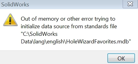

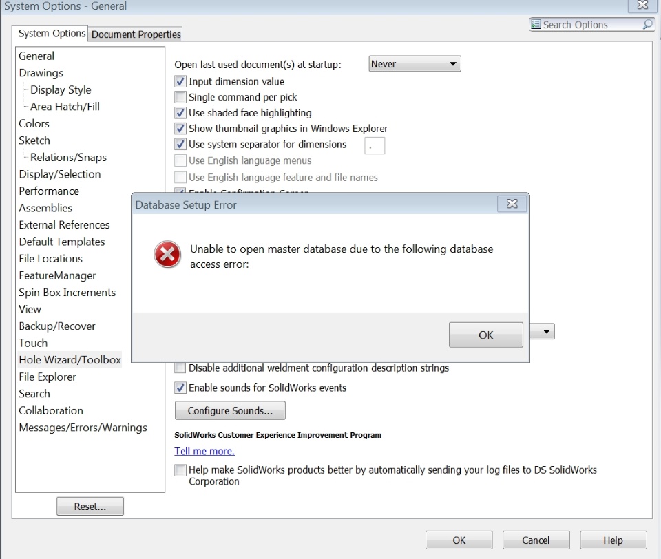

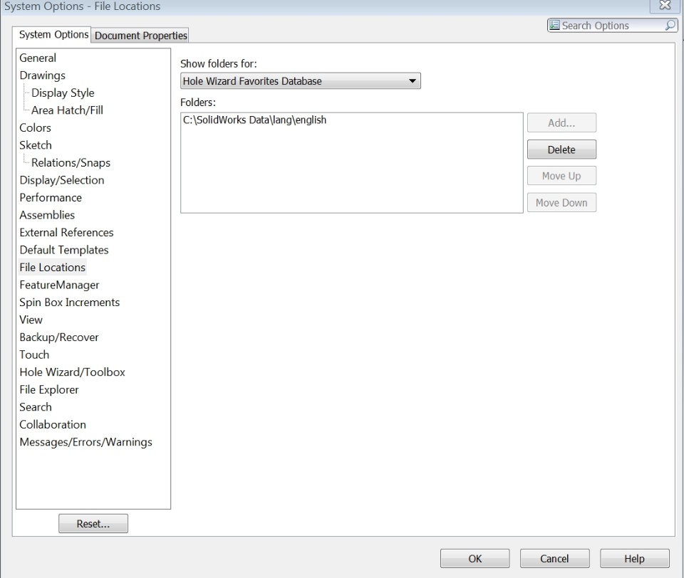

If I click the hole wizard button I get the errors shown in the attachments every time.

Over in the right sidebar check out More Like This....
There is a link to a post about Hole Wizard out of Memory.
If that doesn't help a call to your VAR would be the next step.

You may need to verify that you have write access to both locations.
PM
PM 2013-09-10
SPR # 685318 is fixed in 2013 SP05
