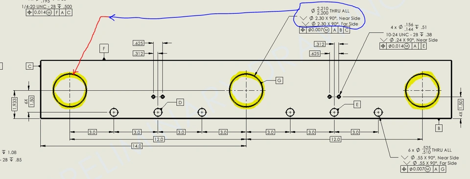

Hole wizard callouts on drawing
Is there a way to replicate a hole callout on these hole features? The pattern of holes highlighted in yellow were created with the hole wizard. I need to use the same hole feature information for the center hole and the holes to the left and the right. The problem is the center hole is my datum feature for the holes to the left and right. I need to add another leader with the feature info and a feature control frame with positional tolerances for the other 2 holes. Seems Solidworks will only let me add 1 hole callout for all 3.

manual insert the hole call out lie Eoghan said.  If you want to auto insert them you may need to make each one a different feature and uncheck the remove duplicates option on the insert.

You can use hole callout from the annotations tab to label each of them individually. If you want to add more leaders, select the existing leader then hold ctrl and click and drag the blue square on the end of it to the other holes and it should make a new leader. If you want to make bend that leader, right click on where you want the bend to be and choose to add jog point

Are they created using the same hole wizard feature or as separate features, have you used the model items to select the outer holes. You can also hold Ctrl and drag an annotation to copy it then release on the other holes.

I don't have your issue with my SW2024. You should be able to add a new branch to your hole callout.

I wouldn't repeat the callout. I would make the callout 3X, attach a datum label directly to the center hole, and attach a frame to each of the holes.
