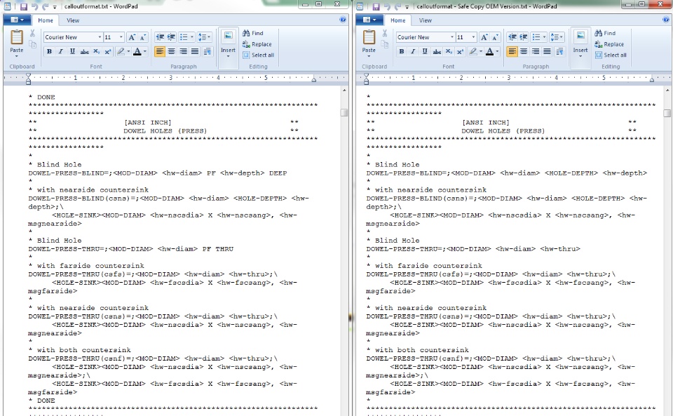

Have you tried to edit the file "calloutformat.txt"?  I did so a few years ago to call a dowel hole "PF" rather than whatever SW default callout is.  (etc, etc, for toolmakers, just like your situation).
Editing the file takes a bit of thinking to find the callouts that are relevant in the long file.  But it goes pretty quickly actually.
Not sure if this fits your situation, this allows changing the callout for all SW standard hole types.
Hope it helps.
Scott

First (truly - first) make a backup file of "calloutformat.txt", then edit the actual file.  SW looks for that exact filename.
comment imagecomment image

Hi Robert,
The callouts are per hole style that is selected in SW, regardless of size.  For special holes, if they are standard SW holes, the callout will be per that style.  Maybe special hole types can be made for o-ring seats (not sure if SW has this hole type or not, we don't use these)
Looking through the calloutformat file, there are many rows of comments/notes that begin with *.  These comment rows do nothing, they are just notes to help manage the various items.  The hole callouts are broken into sections with headers, you'll need to browse through the entire file to see which ones are relevant for your needs.  (most sections probably do not apply).  It's broken down pretty finely, for example there are dowel holes press fit dowel holes standard fit, and dowel holes clearance fit - each with different callouts.  Below and attached is a snippet of my calloutformat file on the left compared to the standard SW on the right.  For press fit inch dowels, we use the suffix "PF xx DEEP" instead of the SW standard " xxx".  We don't use countersink on dowel holes, so I only modified the Blind and Through hole section.  (side note - the thru hole section is mis-labeled as blind right from SW)
Hope this helps,
Scott
