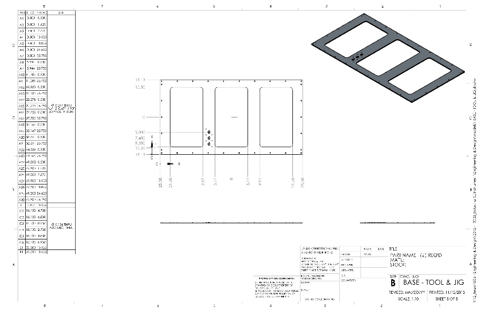

Is there any way to put a hole table origin at a non-solid point?  I have a symmetric part that my ordinate dimensions reference the 2 planes of symmetry.  But because there is a rectangular cutout there I can't see any way to place the origin.  I've tried sketches and axes and origins and coordinate systems but none work, SW only lets you pick edges from what I can tell.
Hints?

JG 2013-11-12 Best Answer
Chris,
You can make a sketch point whereever you want the "0" and pick that as origin
See below
comment imagecomment image

John -
Thanks, I kept making features to reference in the part itself, not on the drawing sheet.

Chris,
Make sure to focus the view before you place the sketch point, so that it stays with the view

John,
I had the same issue as Chris and your answer worked for me in my top view but I also have holes on the front and back faces of the same model that I would like to use the same method of locating the hole table origin.  I added the point to the front view but after selecting “Next View” and prompted to place the origin, the point is not selectable.
Do you know if this method should work in a projected view?
