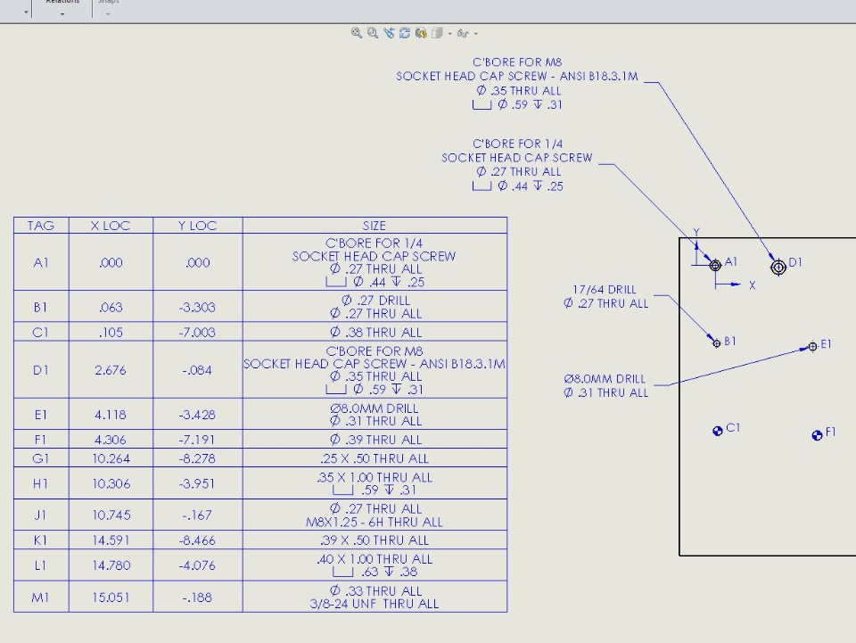

I've added <hw-fstsze> to my Inch plain hole callout.  It shows the proper fastener size when i place a hole note, but it shows the decimal equivalent in the hole table.  With the same metric callout I'm fine.  Also under my counter bore callout I've added this same note and it works just fine.  Anyone run into this?

We are looking a B1 hole

Over in the feature manager on the left for the hole table select the check box to show ANSI size.  SW defaults to show decimal unless that is checked.  You can setup your document templates to keep this toggled on.  See Document Properties for that toggle.
Cheers,
Anna

Thanks Anna that's awesome.  All this time it was my hole table settings and not my hole wizard or callout settings.
