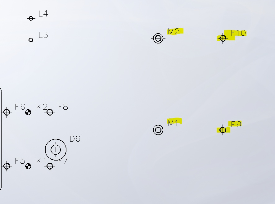

I'm using SW Premium 2018 SP4.0 and I'm having an issue with a hole table. I have a threaded hole that has a counterbore on it. The C'Bore shows up in the table, but the M6 threaded hole does not. I've tried separating the two threaded holes from the rest and separately placing them after the C'Bore. Originally the C'Bore was an extruded cut concentric to the threaded hole. M1 & M2 are the C'Bores. There should also be F11 & F12. No matter what I try, it's not happening. Any suggestions? For now I'm going to put in a hole callout to ensure that the holes get placed.

The Hole Table picks up all the holes on a selected face.  As they're a separate feature the tapped holes inside the counterbores are starting on a different face.  So when you're defining the Hole Table, also select the faces that make up the base of the Counterbore holes too;
Not ideal but it gets the job done.

Since Hole Wizard places one entity type per HW feature, a threaded cbore is 2 features (aka 2 holes).
One way around this is to use Advanced Hole (Hole "A", but I can't remember if AH was in SW2018 or if so, whether it was worth the bother as when it first came out I remember callouts didn't work too well):

Some times I've had to pick the back face if the holes go all the way thru. Then it gets just the tapped holes & not the counterbored holes.

I had to place two hole callouts. We placed the threaded holes then added the C'Bores. Although when I changed the sequence, there was no change in the callouts. Still would not add the "F11" and "F12" threaded holes to the hole table.
