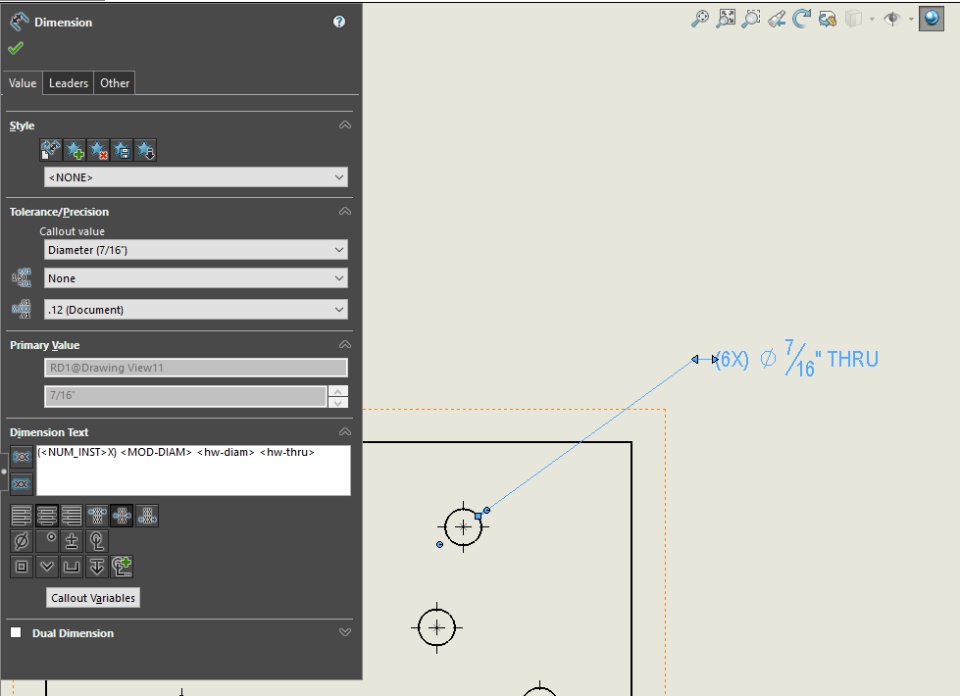

I want to have the default hole callout to have parenthesis around the quantity.
However, in the calloutformat.txt file, I cannot find the command.
Where might I be able to change the default to have parenthesis instead of adding to the Dimension Text every time?

Not a perfect solution, but I found this in an old post.
https://forum.solidworks.com/thread/211008
MA
MA 2021-04-09
By default, the "NO-NUMBER-OF-INSTANCES" line is commented out. That means SW automatically inserts X at the beginning of the callout as necessary. If you remove the comment, then SW will not automatically add any instance counts. Now you can manually add the instance counts in the desired format - "(X) ". Only problem with this is that you will have "1X " in front of single instance holes which you will need to manually delete.

I read this, however the is not in the txt file. Somehow it shows in the drawing though.
