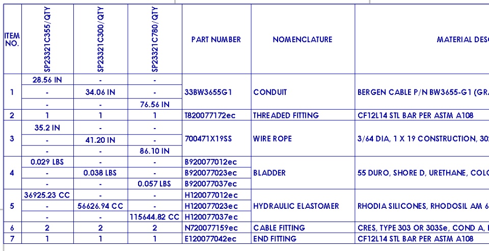

Ho do I override the QTY column header on multi-config assemblies
I have a generic drawing set up for a multiple configuration assembly. The QTY column has the standard /QTY header but I want to lose the / text and just have QTY but when I edit the cell and rebuild the drawing the header reverts back to the default setting of /QTY.

Jody,
Are you able to get this to work for "Bulk Quantities"?
Example: If you have a file properties like; AR for As required orspecific quantities like; OZ or CC with different amounts?
This problem is killing me so any help/input would be greatlyappreciated.

That's okay Kelvin,
I am just frustrated that tabulated BOMs do not work the way theyneed to and as I said, it's killing me. The only way to get the jobdone requires manual intervention and this should not be the case.
I am aware of incorporating custom properties and the additionalmethod of equations with conditional statements using "IF", howeverneither provides for what I require, see image below.
NOTE: If anyone has any ideas, I'd be more than willing, happyactually, to test any suggestions, ...this includes you Solidworks!!!
