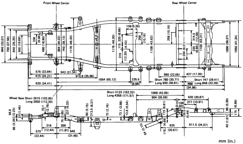

I'm pickling my brains trying to get started on modeling this chassis
[IMG]http://img.photobucket.com/albums/0803/an1mal_69/854runnerFrame.gif[/IMG]
whats the best way to go about it?  I am a beginner, is this running before i can walk?

just to add, the accuracy of the cross bracing etc is not important really, its just the chassis rails im after.

Draw a dotted line construction line down the center.
Draw the left side and then mirror it.
There I just cut you work in half :-)
Are your requirements later going to be that you need to take off a crossmember and work on that? Or can you just draw it all as 1 part?
You can make it a part, or an assembly of parts.

Its really for mocking up suspension designs, so just one brace at the front & rear will suffice.  I will add different cross members with different designs etc.
My main issue was getting the correct curves & the fluting of the chassis from a 76mm to 140mm section.  Would it be best practice to do this using different planes for each change in axis?
Also I'm guessing it would be easier to model it as a solid as opposed to the 3mm box section it is?

You can model it as solid and use the shell feature to hollow it out after.
You can mirror a sketch easy or you can make a left rail and then easily click on create a mirror part.
Its kinda funny. the drawing does not specify all the geometry of the rails.
It does give exact locations for mounting points. It kinda does not matter if the rails are off a little as long as the mounting points are right you can assemble the truck!!
You never know where something not shown like an exhaust pipe might hit the rail then though.
So with this drawing it will be ... That Looks About Right.
Unless there is a drawing for the rails with every dimension.

Yea, the drawing is not fully defined, the arcs for example, and the origin for the arcs to start and finish etc, but like you say I should be able to come up with a pretty accurate model from that drawing.  I've run through the tutorials a couple of times, lofting etc, hence my thinking on the planes.  I guess more study is needed!!  I have 'the Bible' but I've been using it as a reference more than working through it..

Planes at angles and lofting is pretty good to get the front end where it curves and tapers down smaller a the same time ...

You can insert the image into a sketch and then scale it and use that as a background. search insert image.

I would try to use a Sweep with Guide Curves to generate the box section as a solid, then Shell it.The tricky part is that the path and guide curves don't stay in just one plane. You will need either a 3D Sketch or use Projected Curves. I would use the latter if at all possible, as they are much easier to work with. In fact I would use Project Curve anyway. If Sweep won't accept the Curve as a path or guide curve, then open a 3D Sketch and use Convert Entities on the Curve to get your path or guide curve.

Thanks for the reply Jerry! I did get round it in the end, I sketched the chassis on the right plane as sheet metal @ 75mm, then used sketch bend @ 10* with a 450mm radius, finally, used the shell feature to give a 4mm wall. It looks great, I'll grab some caps' next time I'm on there.
