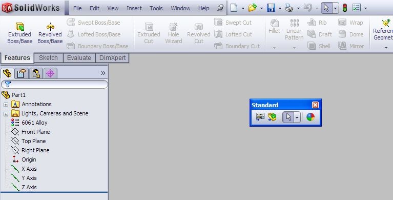

I've set up a new tab in command manager with all the standard tools on it but I can't get rid of the standard tool bar. Is it possible?SolidworksUser Interface

Which Standard toolbar do you mean?
The one in the top RH corner of the attached image, or the actual toolbar shown floating in the graphics area?

The top RH corner one

Hi Derek,
You cannot remove the whole thing at once, but while in the customize command, simply drag the buttons off of it one by one to remove them.
