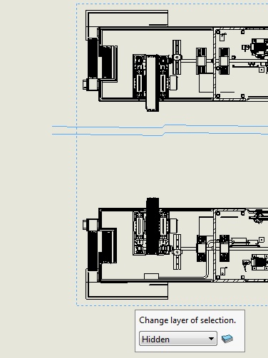

I am trying to do something that I would think is incredibly simple... I want to hide the break lines in a "Break View".  What I thought would work was to add a layer to the drawing and turn that layers visibility off.  Then I right clicked on the break lines and changed their layer to the hidden layer.  The break lines still show in the PDF:

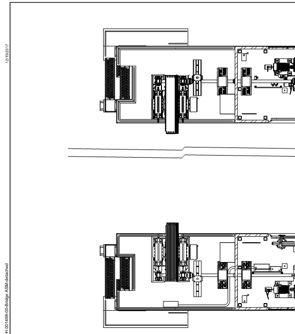

Here's from the generated pdf:
Anybody got a solution for this?

Thanks (thanks Scott and Bjorn, too), I looked into it more and got it to work.
Okay, I do not understand why this works the way it does.  Can someone please explain to me why if I click the "Eye" icon it grey's out the print Icon in the Layers pallet, but yet it still prints?:
Now, If I show that layer, then click the Print Icon first and turn off printing, like so:
Then click the Eye, then the break lines disappear as they should:
So, you have to click the Print Icon first, then the Eye Icon to have the break lines disappear and not print....That is the definition of buggy behavior to me.  Is there a reason it works this way that I'm missing?
