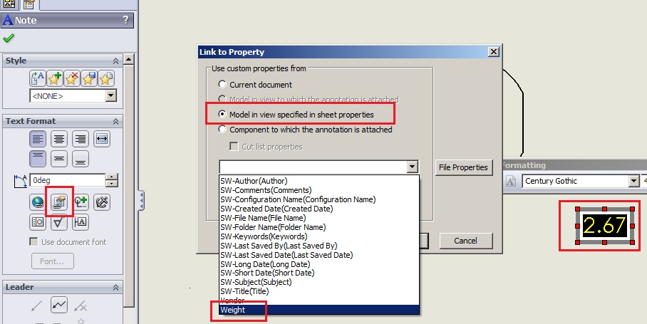

Is it possible to hide a line/border of a cell in BOM?
I was trying to hide the uppermost line in particular.
What I`m trying to achieve is to place Total Weight of the assembly just above the BOM.
Since I did not find a way to just create a note then link the value of that note to the total weight,
what I did is to create an additional row above and added an Equation to get the Total Weight.
Then just hide the borders or the added row so that the Total Weight is as if a Note.
Hoping someone could help, I`ve been working on this for 2 days.
Thanks in advance!

DG
DG 2013-09-04 Best Answer
I'm not sure if you can the cell border but you can link the note to display the assembly weight. Add the note and link it to the weight property of the assembly (not the total weight in the BOM).

Hello Mr.Gupta,
The total mass of the assembly which is computed by Solidworks(Tool>Mass Properties) is not equal to the total weight of the BOM below.
I got the total weight of BOM by using the "TOTAL" function.
According to my Client, I should use the total weight on the BOM.
My follow-up question is that; Is there a way to link a Note to a value of a cell in a BOM?
If not, do you have a known work-around for this?
Thanks in advance.
