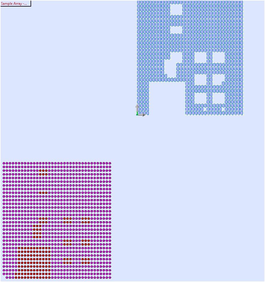

i have an assembly with a component array of planar surfacesrepresenting solar panels and their mounts. the array is placedinto another assembly and overlayed onto another componenent thatis nothing but a sketch of the rooftop and its features such asHVAC units. for this project i have to walk thru the array and"delete" the panels and supports that intefere. seems simpleenough.

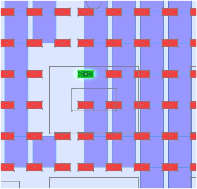

issue 1: (see image) when i select a surface, SW makes the sketchof the blue panel and the red mount visible. this drasticallyclutters the screen and makes selection difficult since there canbe thousands of components. i have to manually turn it offeverytime.
issue 2: (see image) when editing the array to remove "instances toskip" the buttons for the instances are offset so it is impossibleto select the proper button. this only happens when editing thearray in the top level assembly. if i edit the component array itsassy, it works fine. oh, this issue does not seem to show up on winXP, only in vista64.

On the first issue, are you saying the sketch automaticallyswitches from being hidden to being shown (it actually flips theswitch and you have to change it back)? One thing to check is lookto see if Instant3D is turned on in the Feature tab of theCommandManager or features toolbar. Instant3D does some automatichiding/showing and previewing so you can try turning it off. IfInstant3D is off and this is happening, this does not sound like acorrect behavior that I am aware of and should be reported to yourreseller so they can get it in to our Technical Support department.
The second issue definitely sounds like an x64 specific defect andshould be reported through your reseller so an SPR can be assignedto it.

Yes the sketch automatically turns to "show" and stays shown.Instant 3D is not on.
looks like these are 2 bugs.
