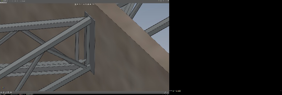

I am having issues with my e-drawings all the while as the hidden lines are visible on my model in edrawings. I have checked youtube and found out that there is no such issue in other edrawings of others. I just want the visible edges to show.
Is it a setting in solidworks which I must toggle before exporting to edrawings that I am missing?
Attached is the picture of the problem.

I don't see any hidden lines at all.  So they are not visible.   I guess I don't understand the problem.
Which one do you mean?
1) Do you WANT hidden lines to be visible?
or
2) Do you mean that these lines are visible and you don't want them to be:

Hi, If you zoom into the picture, the lines which are behind the model are visible. What I wanted is shaded with edges but hidden lines removed. Im using an AMD W7000 graphic card by the way.

I have another computer which uses another graphic card but the issue seems to be persistent. I can share a simple model here soon.

<p>Teh Teh wrote:</p><p></p><p>Hi, If you zoom into the picture, the lines which are behind the model are visible. What I wanted is shaded with edges but hidden lines removed. Im using an AMD W7000 graphic card by the way. </p>
Ahh.  This may be a function of thin parts.

I have just created a small simple model and exported to edrawings and it works fine.
However, when I export multibody structures, the hidden lines show. Weird.
Only happens in edrawings by the way.
Here's a 200mm thick wall in a multibody part, which is part of the above picture.
Here's the small single U Beam weldment that I created which is normal:
