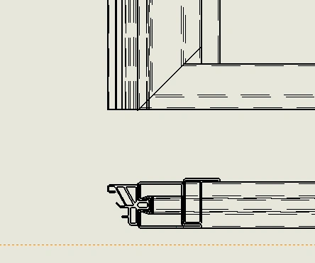

Hi,
Can I define a body for a part so that its hidden edges are not displayed in 2D?
For example, for this seal only the "visible edges" should be visible in the front view,
while for the profile the hidden edges should be visible?
This is a part with multiple bodies, not an assembly.
Thanks, Linda
